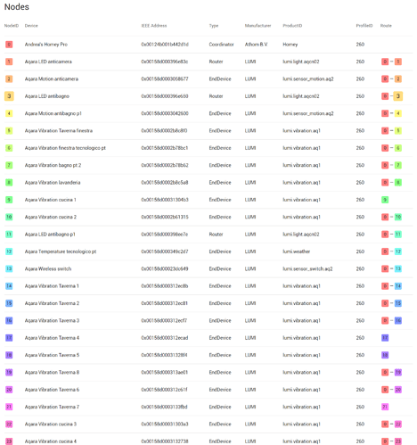

I am not aware of a limit. I have the early 2016 homey. The mesh network indeed does not show what the real mesh network is. I expact this is a bug and hope the zigbee rewrite athom is busy with will solve that problem. I experimented with the zigbee powerplugs as routers. Without these i have connection problems with the battery powered devices. The zigbee mesh shows all the devices are 1:1 connected with homey. After plugging in the power plugs the connection problems have solved, but the zigbee mesh shows that all the devices still are 1:1 conbected with homey.
It will often take a while (minutes) before the proper routes are being shown (although, AFAIK, router devices are always shown to be directly connected to Homey, even though at least in theory, they don’t have to be).
my network is so formed:
there are about 22 battery-powered peripherals and 3 peripherals that act as routers. all the devices connect directly to homey (even moving it). I assume it’s a homey bug as with other zigbee controllers (see zipgate) for eedomus there are no such problems.

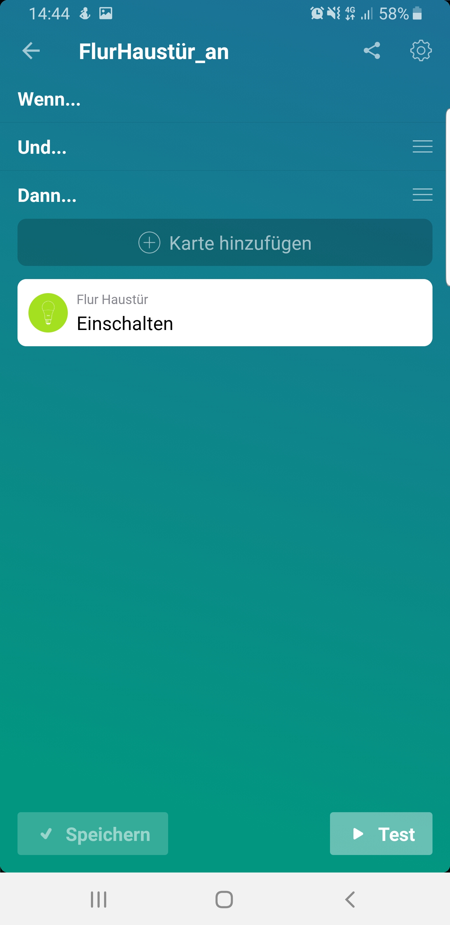

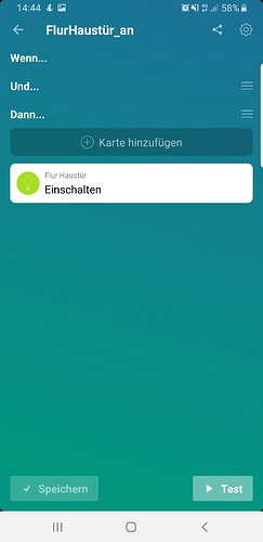

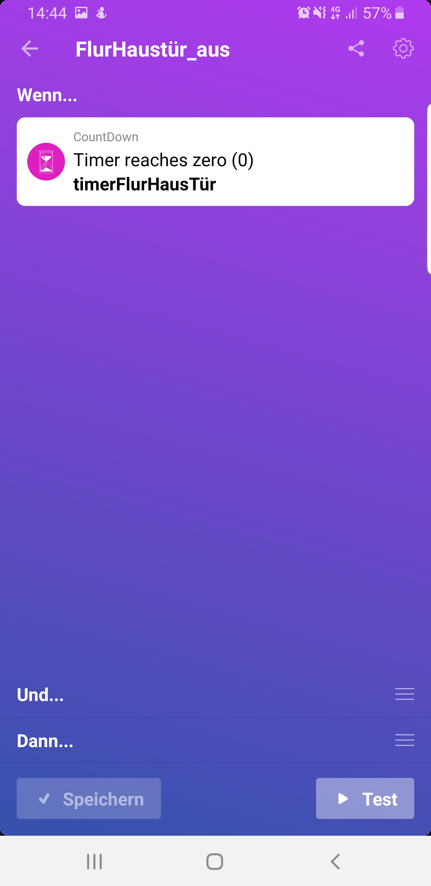

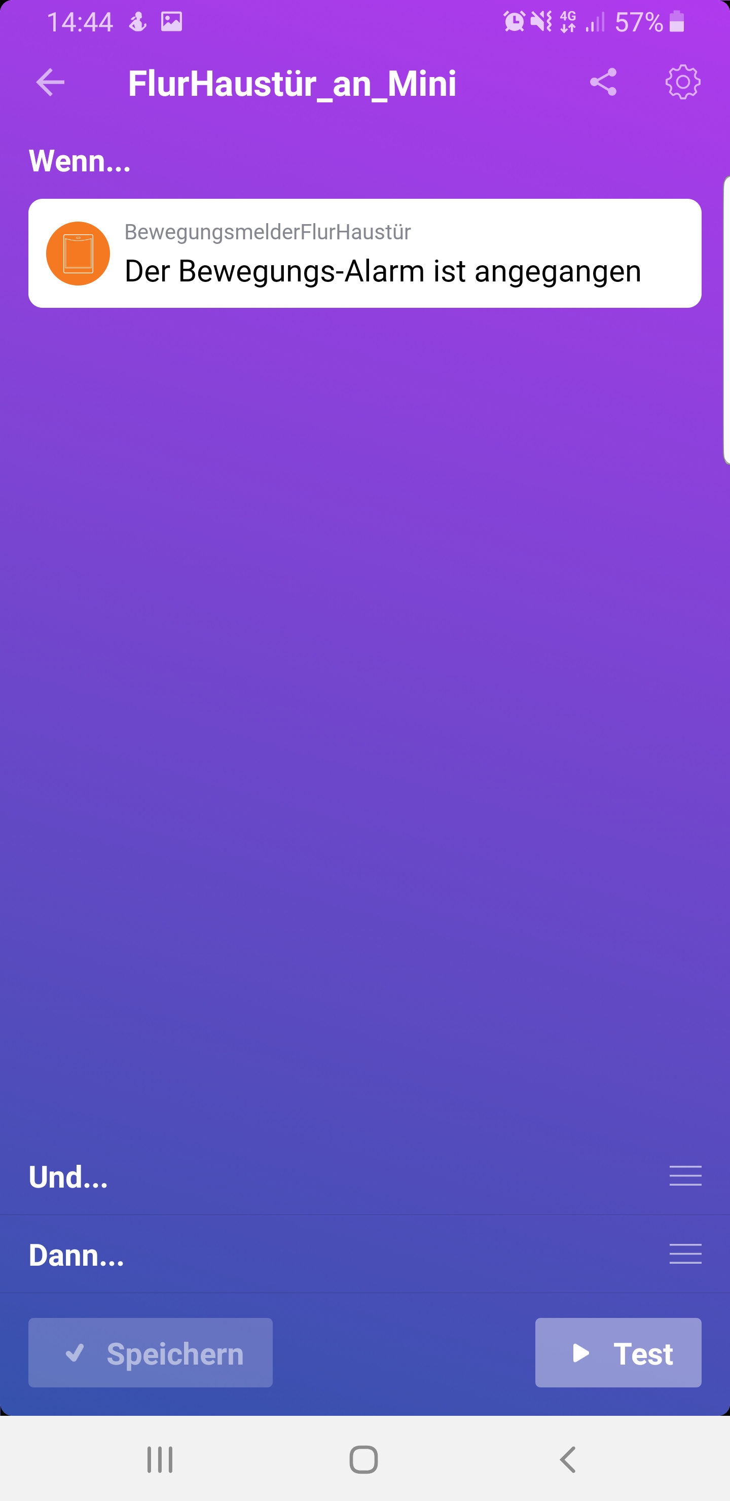

I’m working with count downs start and adjust
flow:
maybe this will solve your issues also
