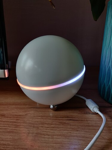

My Homey Pro (early 2019) are not reacting on changing the LED ring settings.
I cannot turn it of and it seems to be stocked in some undefined mode - where the color is half orange and half lightblue. I between the two colors it looks like the chosen LED effekt, from the settings, is set. But that’s just a small line of the total ring.

No success. When it starting up again the it still just shows a light all around, and a small spot where the light effect is activated.

When I select “off” mode, the LED ring is turned off. And when select an effect it’s active on the whole led ring. Seems to work now.
