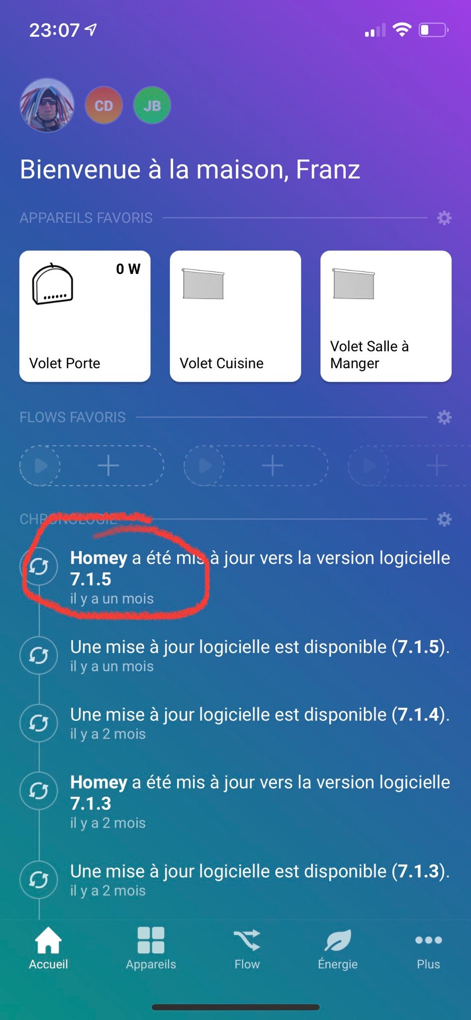

Yes it is true, well it was my error, you cannot downgrade the firmware when you are on a live firmware (therefore, you are out of “experimental scope”).
Too fast, after restoring the backup, I thought I was in version 7.1.5
But in fact I was fine in version 7.1.6:
But after I restored the backup, although I was still on version 7.1.6, my Zigbee network issue was gone … all of my devices were back to working. Restoring the backup therefore solved the problem.
If you are not in live firmware but in “experimental mode”, when you start a restore procedure, this rollback functionality is available: under firmware verification, you must keep the ALT button pressed, you will be able to return to the ** latest stable version **. Which is the current version !
