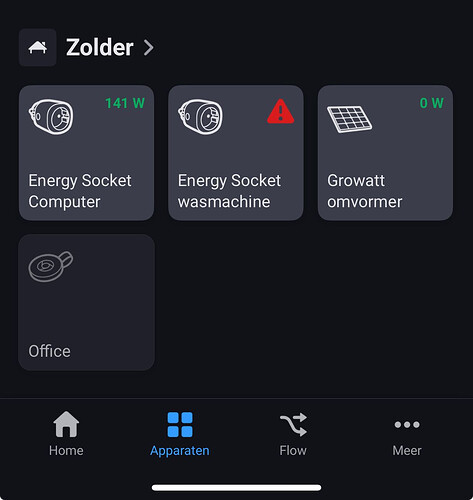

Here a screen of one plug not working while another one does (sometimes its the other way around):
