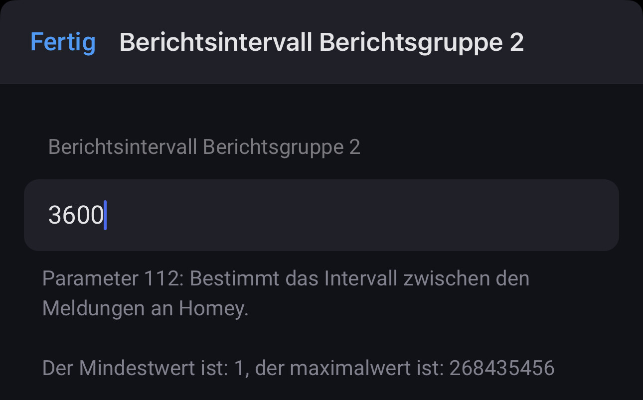

Take a look here in this Thread for e.g. Aeotec ZW075. Think, but not sure, you can try the settings:
https://community.homey.app/t/homey-pro-2023-zwave-too-much-traffic-error/84036/222

Homey > Your Device > Settings > Advanced Settings (think it is Advanced Settings > Erweiterte Einstellungen) at the Bottom.
Then you should see all Parameters of the Device. When tapping on a Paramter to change you see the Number and Description for this Paramter.
You have to change the Settings on each Device and not in the Settings of the App.
