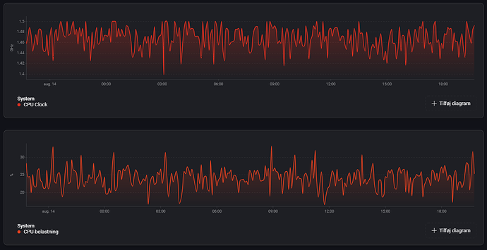

I have an issue with the Honey Pro 2023.
It is running unstable and will not turn on the light when the switch is activated, or it is delayed 5 to 10 seconds.
The System CPU Clock is high (see picture below) and I have 67 zigbee devices attach to the Homey.
Is it a problem with 67 Zigbee devices??

CPU clock looks pretty similar to my Homey and I don’t even use it for anything. Your CPU load is showing at most about 35%, so no problem.
The rest of your story isn’t very clear. Do you only have issues with Zigbee? Only a specific device? A specific flow? Did you do a PtP?
Can you share CPU utilisation and CPU frequency for eg. 6 hours only or 1 hour ? Btw best is to install sysinternals to diagnose such kind of issues but first I would probably follow on questions raised by Robert, as Zigbee devices are kind of specific…

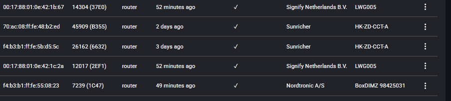

During the last months I have worked with the issues mentioned above and I have not succeeded. The Homey Pro is still not working properly.
The issues are.
  • When the wall contacts are activated, the light is not always responding or only some of the lights are responding.
  • If I use the app to activate the light it is working much better.
Observations.
  • When I look in the Homey developer tool at the wireless Zigbee devices I can see that some of the devices have not been seen for days or weeks. Why is that??? See picture
    * When I ping the devise with high last seen it is responding again to activation with wall
    contact.
    * After some days it is a new device that has the same issue.
  • I have installed 4 additional Homey Bridges to improve the wireless coverage, but it has not solved the problem.
I hope you could help???

It is more that the homey stop to see (communicate with) some of the components and when you then activate the wall contact it is not responding until you ping it.
Is there an app that could ping components that not have been seen for some time???
