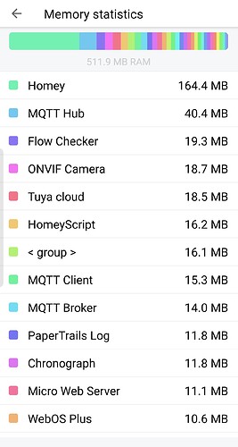

How can I get the graph as you show in this post memory graph?

About the memory graph.
I’m I right if I say that the graph that they show on this link is not available anymore. I knew about the Insights but I wanted to find the one where you see them as a bar.
