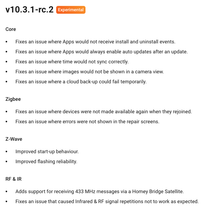

Has anyone tried the new 10.3.1 preview version yet? Sounds like this might be able to mitigate the issues
Homey Pro (Early 2023) Changelog | Homey
Ive been testing for a few days but doesn’t seem to have fixed the random Zigbee issues, at least not with my Aqara devices.

I am using the v10.3.1-rc.2 update for a few days now, and not facing problems. I use a lot of Zigbee devices as well.

How do i download this version?
Hi
You need to enable experimental test updates in the Homey Developer Tools (https://tools.developer.homey.app/) however, be warned you cannot revert back if you have an issue, you will have to manually reset the unit and start from scratch so don’t do this unless you are confident on what you are doing.
I’ve been testing it and it does seem better although I have still had one or two issues since updating - it is certainly more stable.
