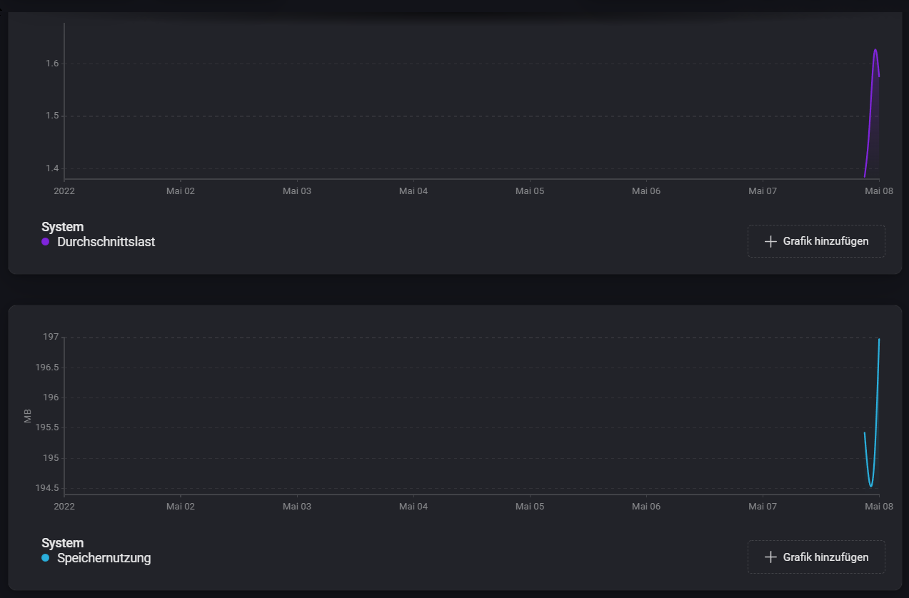

What does the System - Average Load graph say?

About the System Average load graph, can you select a bigger timeframe, like 31 days?
