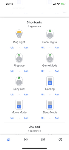

Create a virtual device, for instance Sleep Mode. Then create a flow where when = “virtual device on” & then = “run Flow Sleep Mode” and select that flow. Then you can just tell home to “turn on Sleep Mode. That will switch on the virtual device, wich then will trigger the flow.
I added a “turn off switch” in that flow too. So the virtual devide doesn’t stay on, preventing you to turn it on later (otherwise you manually have to switch it off and and then turn it on for the flow to trigger)

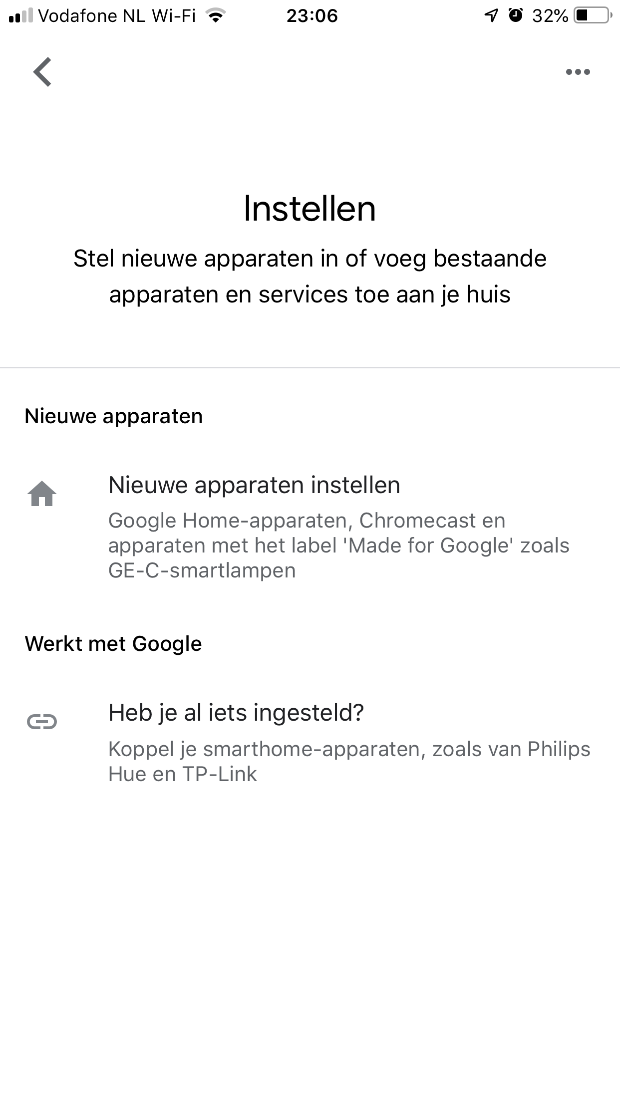

First unlink
After that
Go ‘Google Home’
Go ‘Add / toevoegen’
Go ‘Set device /apparaat instellen’
Click ‘Already set something / heb je al iets ingesteld’
In the list search Homey and click on it to link IT correctly.

Also, if you have multiple flows you might want to create a room for those. It makes it a lot more convenient and prevents starting it by accident if it looks similair to a different device in your living room. This is how I have it for example.

I keep getting the message “something went wrong try again” (in Dutch)
I did unlink on Homey side.
What can be wrong.
You did unlink via https://assistant.google.com ?

Yes I did. When I ask google to talk to homey it now says I first have to link homey.
I don”t know what can cause this. Maybe because devices like Hue are already directly linked to Google and are available in Homey?
google first gives the message Homey is linked and after some time that something went wrong.
