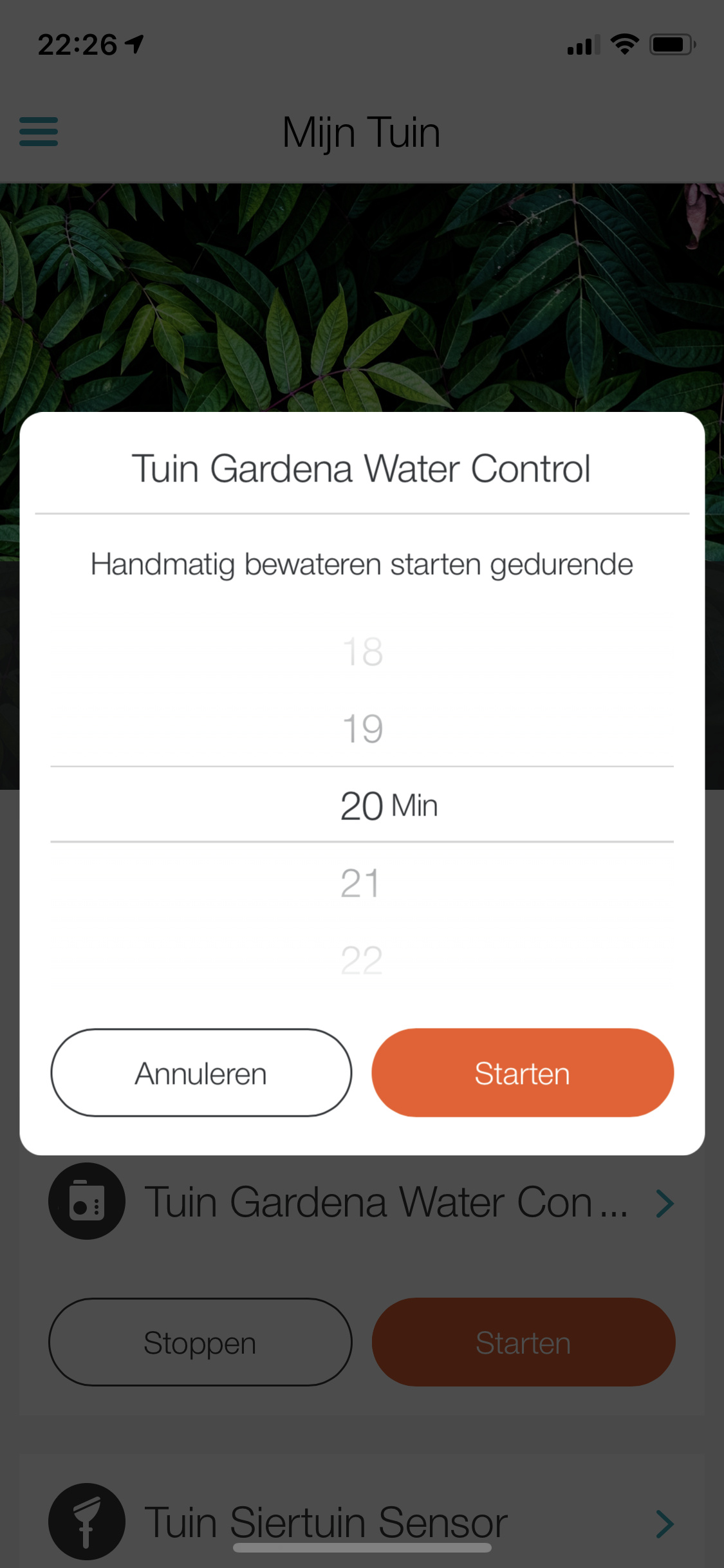

Gardena’s own app(not Homey) does work. But in the app you can set how long you want to water. Standard for me is 1 minute. Maybe, just maybe this setting is your problem.

In the original gardena app where can i find the 1 minute setting i use ios app but can’t findt
Yes okay,
That works normal here.
