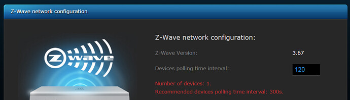

Maybe he means the Device polling time interval:
As far as I know, this cannot be changed on the Homey. However, this should have nothing to do with the described issue.
