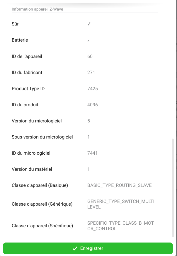

My Walli are V5.1 and Homey V7.2 but what is strange from the start is that these modules differs than other Fibaro roller shutter. Classic one has
And Walli I do not have the up/down screen
Did I done a bad config ?

@Maxime_Cieux all your walli have same version of firmware?

Yes they all have the same version
