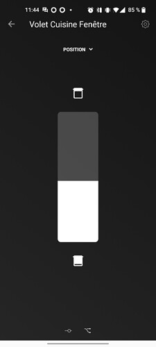

When opening and closing the shutter with Homey, everything’s working fine. But when trying to open them halfly using their position (like 50%), only the older one works fine. The other shutters receive the flow demand (they do a little noise) but they do not move, unless the % is 100 or 0.

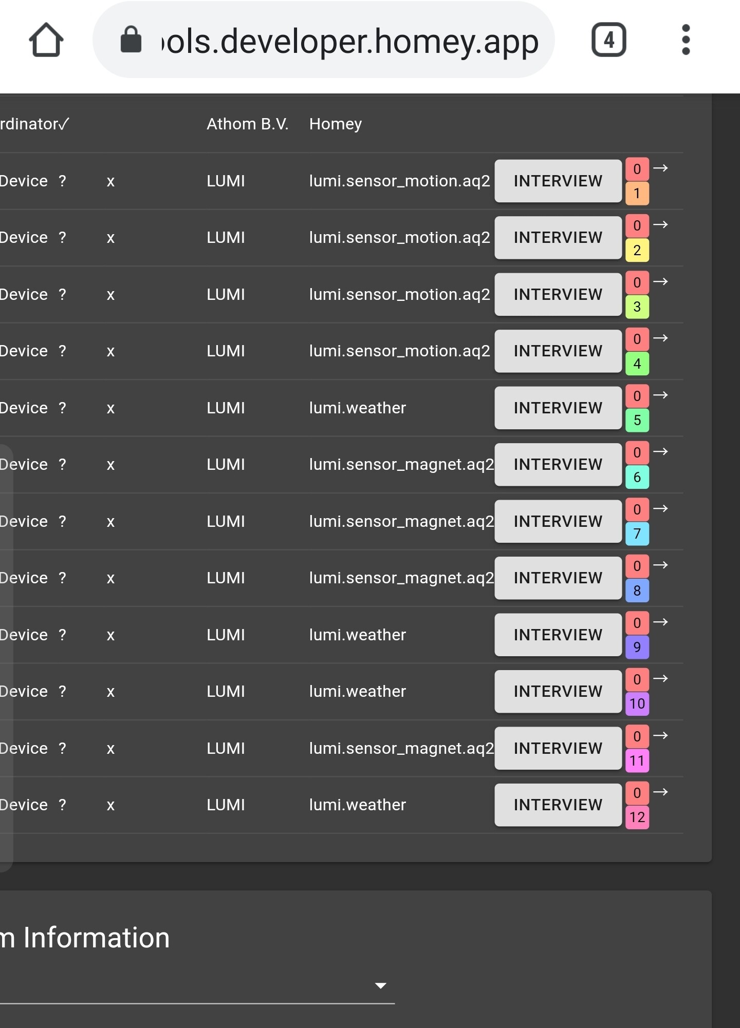

Sometimes “Interviewing” the device can help.
https://tools.developer.homey.app/tools/zwave
What do you mean by interviewing ? I don’t see such an option (but it’s the first time I go to this web page)
I don’t run zwave, but in zigbee it looks like this
Isn’t such a button available on the zwave page? (Could be)
Z-Wave has no interview, instead you can press the 3dots on the right , there you get a menu for Test, Heal and some more, try Test a couple of times with some interval (wait for the response every time)

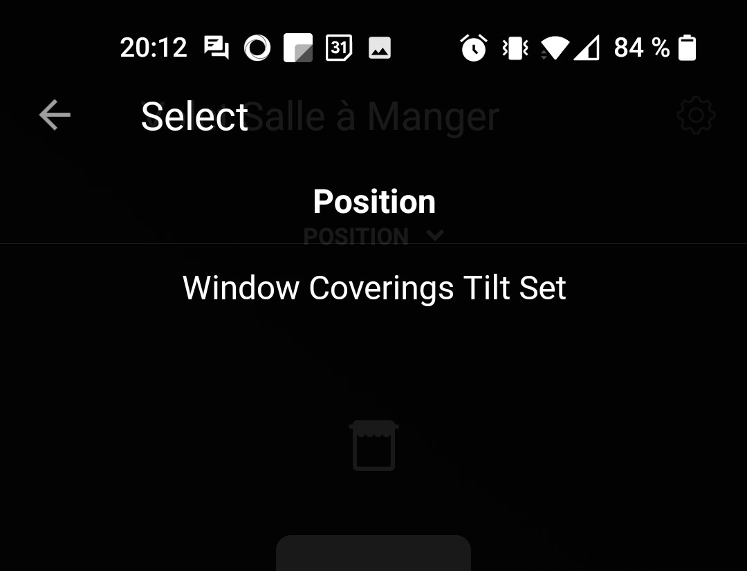

I’ve not found “Advanced Setting” nor Parameter 151 “Operating Mode”, but when I look at the devices parameters using the Developper’s web page, I see different windowcoverings_set Capabilities for each device :
  • for the one that works fine : windowcoverings_set = 1 (and there’s no windowcoverings_tilt_set field)
  • for these which do not works fine : windowcoverings_set = 0 or 1, and there’s another fild windowcoverings_tilt_set is null or = 0, depending on the devices

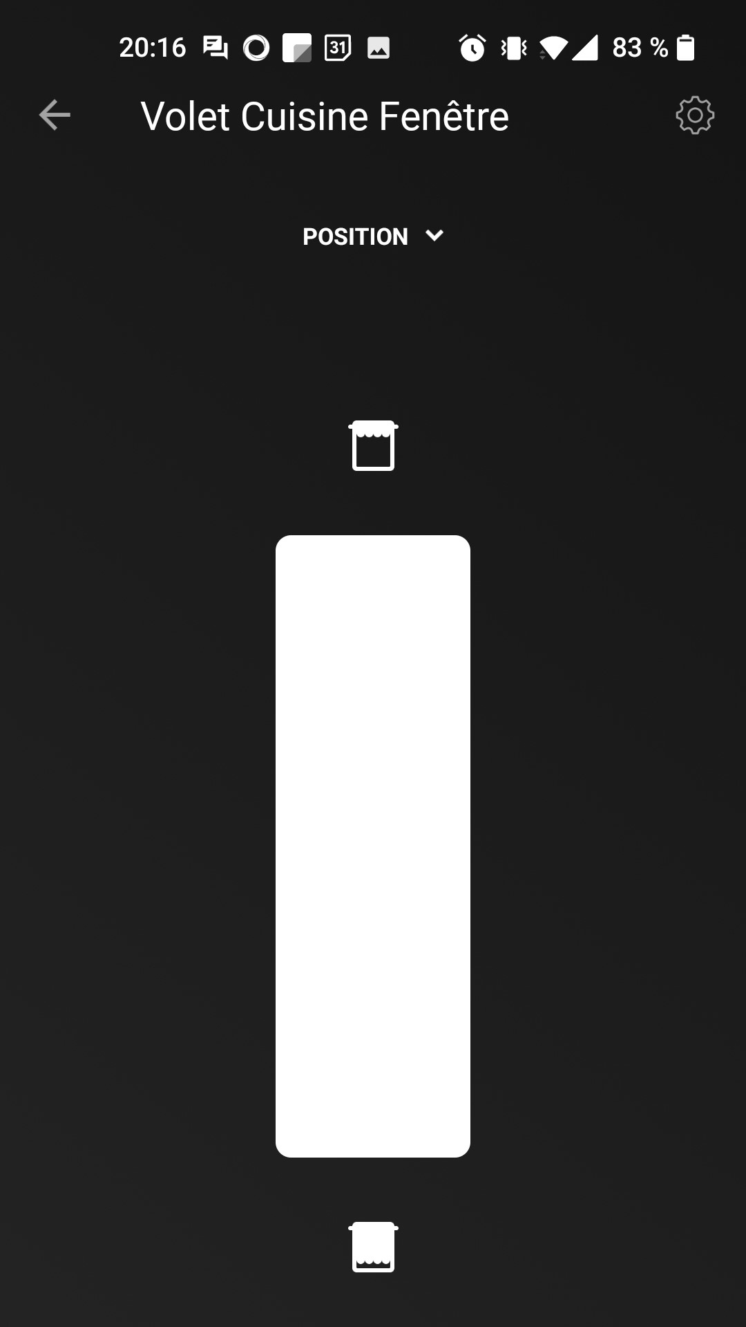

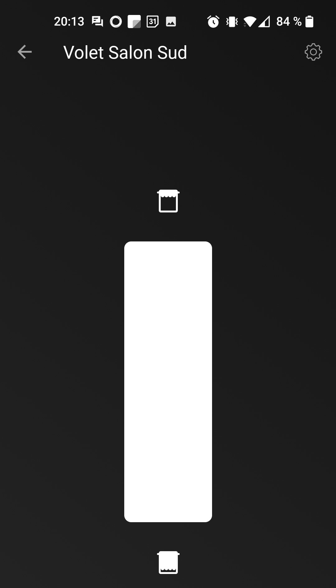

For information, there’s a small difference when using Homey for the devices that do not work fine :
I really don’t understand anything to thses Roller Shutters :pleading_face:
