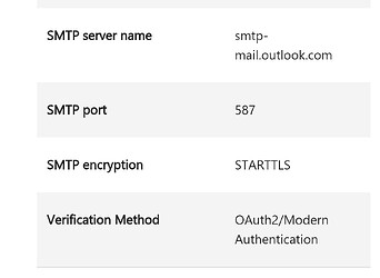

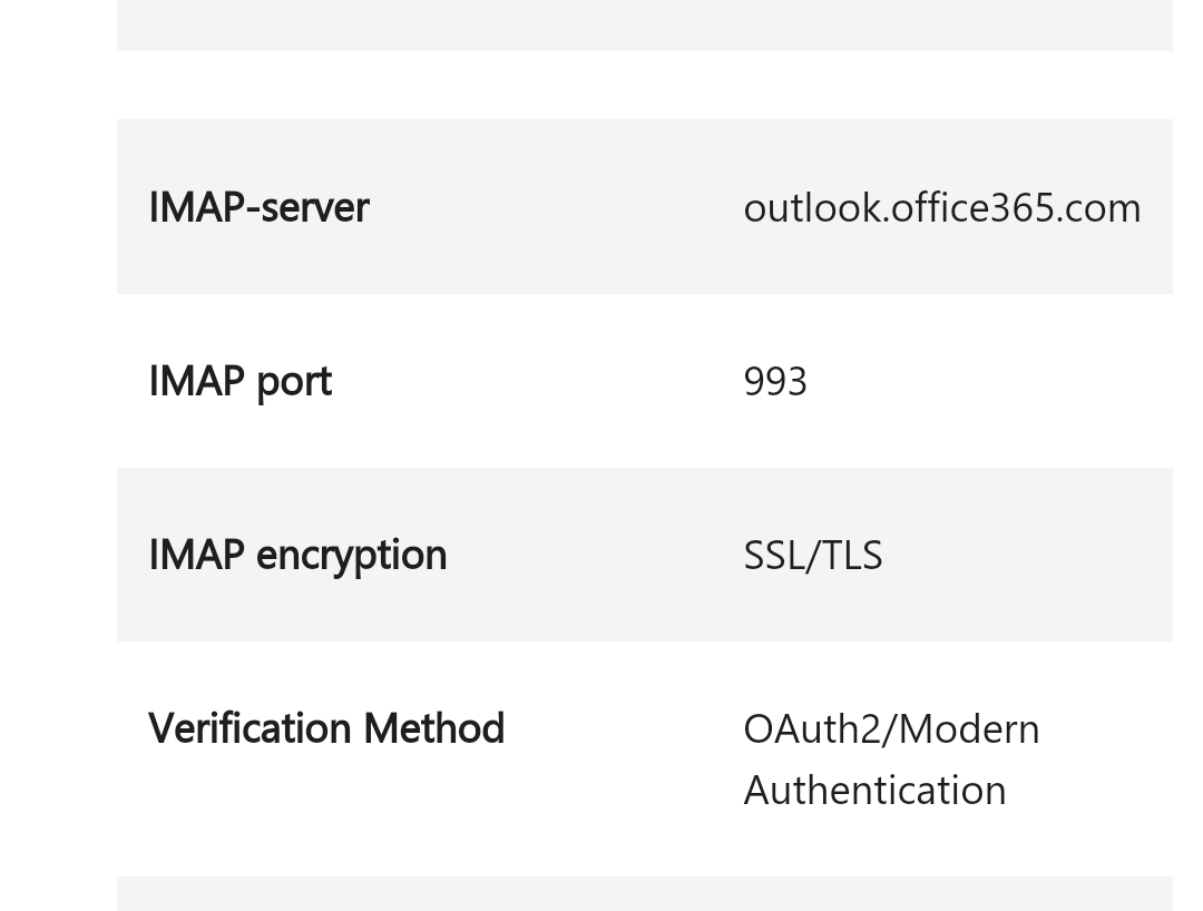

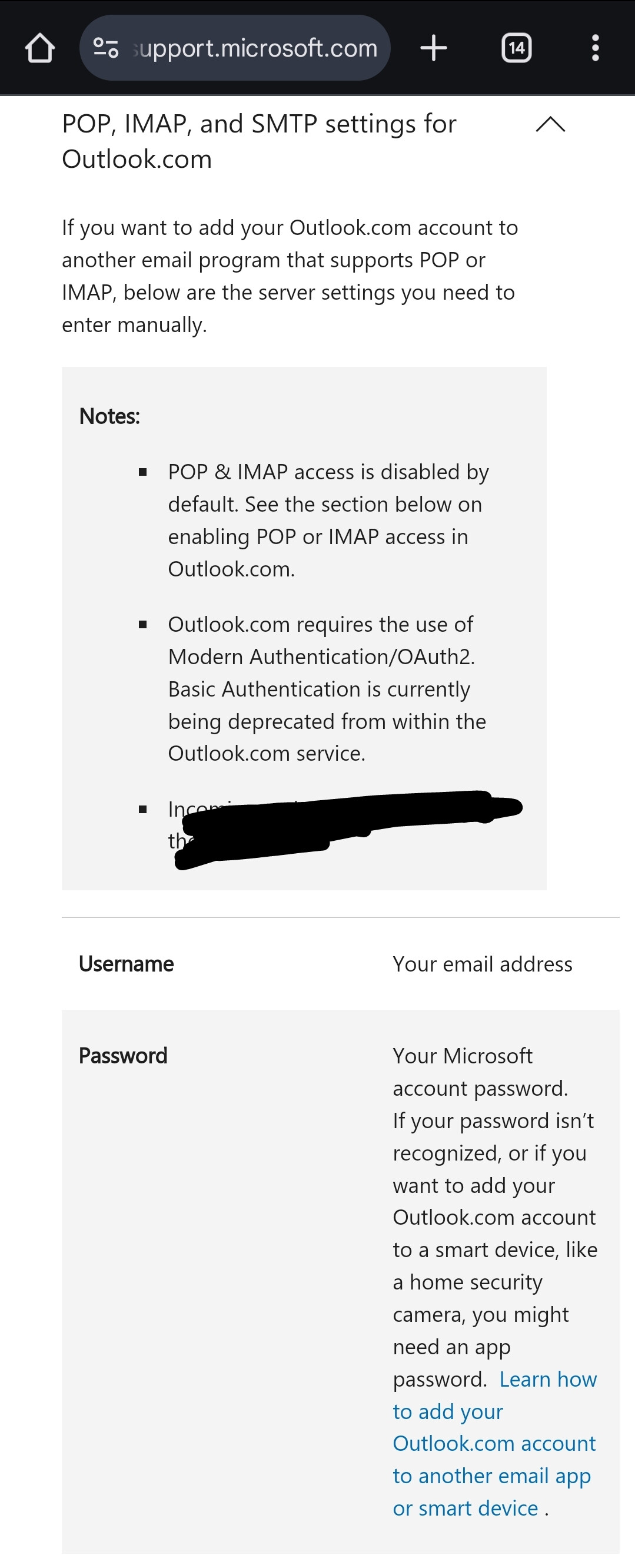

Does anybody now what “Host” and “port number” I had to use for my hotmail.com account? I used “map-mail.outlook.com” and “993” but I get the message “Timed out while authenticating with server”. When I check the box “TLS” I get the message “LOGIN failed”.
Hi Mike,
If you haven’t already, first enable IMAP for your mailbox
https://go.microsoft.com/fwlink/?linkid=875424
Then, configure the app with these settings:
Source

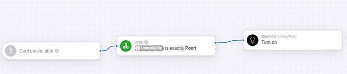

Thank you for the swift response. I am trying to do what Adam’s initial app accomplished. I want to start a flow with “if” block, checking my Gmail inbox to see if I received an email from a specific email address. Furthermore, I also included a screenshot of my current flow, realized it was no longer functional :frowning:
