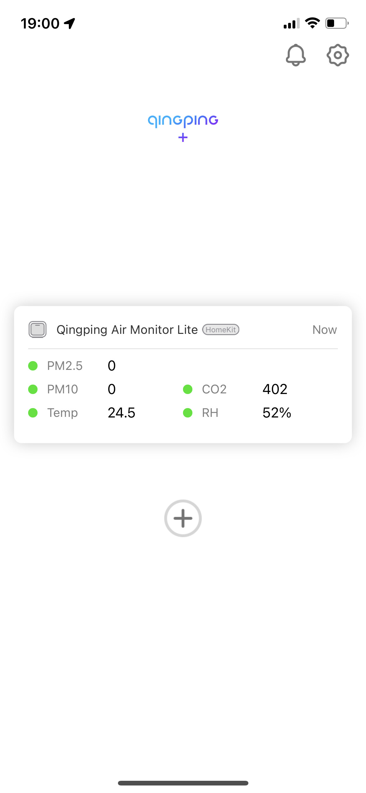

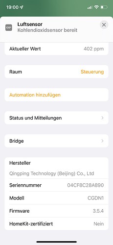

Hey,
HomeKit is only capable of connecting to one controller.
The QingPing app will look for the Air Monitor in your HomeKit App and adding it to the app itself.
This only works if the simulated AccessoryInformation (from HomeyKit) in the HomeKit App matches the expected values like the device was added through the HomeKit app.
I already modified the HomeyKit app to look for devices from the HomeKit Controller app and fill in the necessary informations so they can be picked up by the original apps again.
Device → HomeKit Controller → HomeyKit → HomeKit App → QingPing App
The original app will NOT communicate through HomeKit with the device.
Another quick note
Please do not reset your device since this will erase any WiFi configuration from the device as well! HomeKit Controller is not able to connect to devices which haven’t joined your WiFi network yet.
Removing the device from your HomeKit app simply unpairs it from any assigned controller but keeps the network connection.
Thanks @TheRealLink for the update.
Does this mean you are working on a solution to make this possible to have the sensor back in the QinPing app again?
When I try to add the sensor via HomeyKit to Apple HomeKit, I get the following message:
I really want to have the sensors back in the QingPing app and looking for a solution.
Please let me know when this can be tested. :crossed_fingers:t2:
