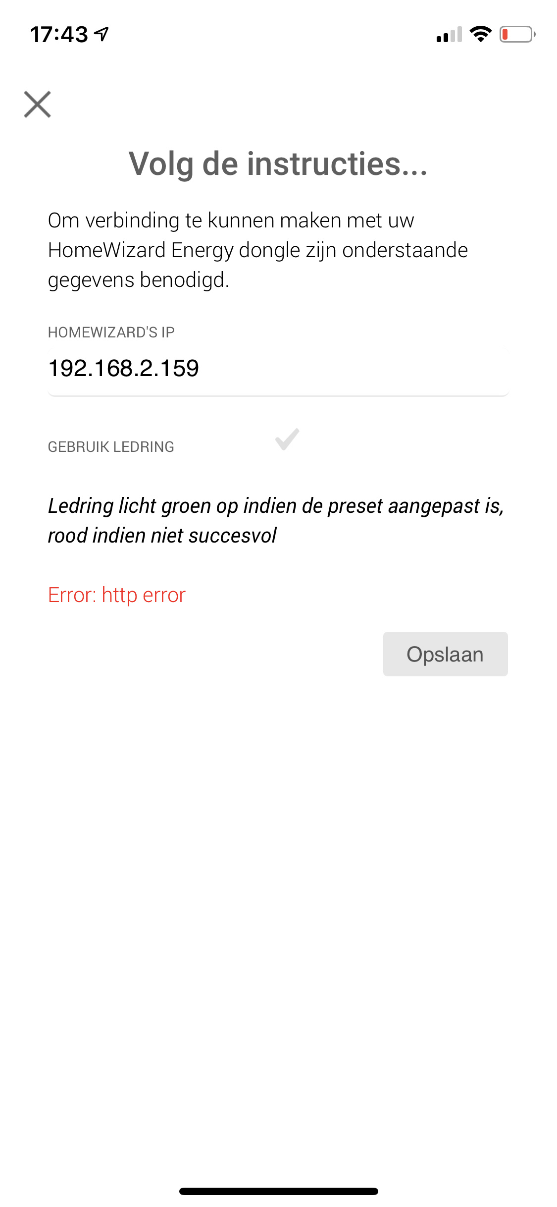

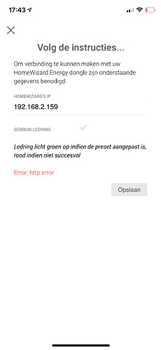

I’m getting the http: error. It is in the same subnet
Hm that is odd. No spaces behind the ipaddress when you enter it in the app?

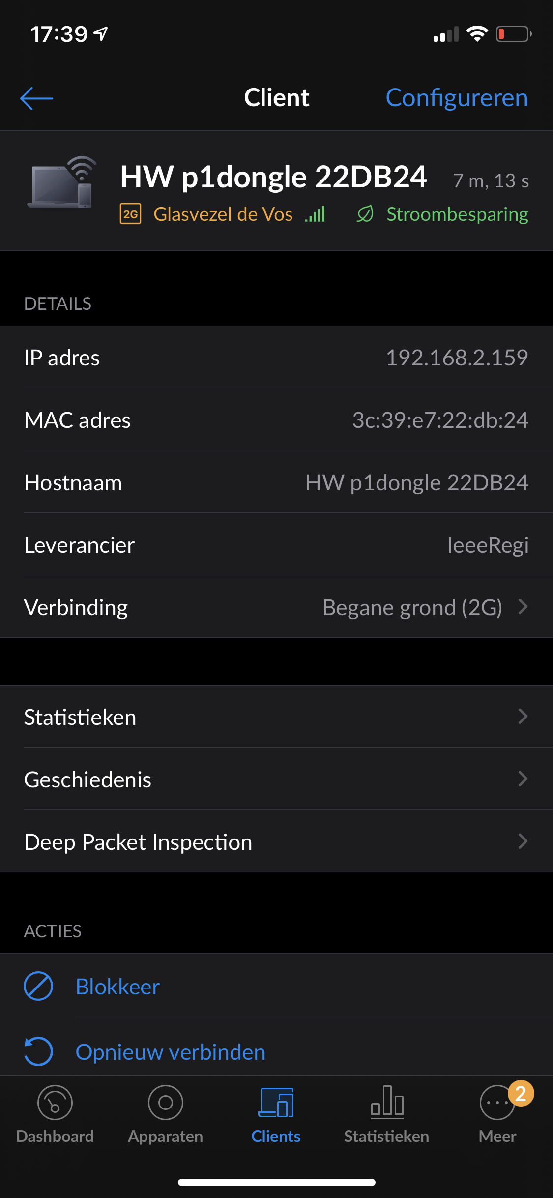

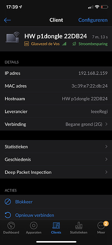

I see you have Ubiquiti do you allow wlan inter traffic (WiFi clients are allowed to see each other?

The inter lan is enabled. I use more WiFi connected devices with homey so that should not be the problem. When I go to http://192.168.2.159/api/v1/data in my browser it says connection refused. But it is connected succesfully to the HomeWizard energy app that reads data from it.

I saw your answer in the above topic an tried several times but i get the same error😢

This is the pairing code, checking if I get http status 200 OK then I check the payload if the smr_version from the P1 port is not NULL (ie. It has a value). Only then I proceed. As you get a denied on the request it will fail on the first check.
var url = ‘http://’ + device.settings.homewizard_ip + ‘/api/v1/data’;
        console.log('Calling '+ url);
        request(url, function (error, response, body) {
            if (response === null || response === undefined) {
                        socket.emit("error", "http error");
                        return;
            if (!error && response.statusCode == 200) {
                var jsonObject = JSON.parse(body);
                console.log (jsonObject);
                if (jsonObject.smr_version != null) {
                    console.log('Call OK');
                    devices[device.data.id] = {
                        settings: device.settings,
                        capabilities: device.capabilities
                    homewizard.setDevices(devices);
                    callback( null, devices );
                    socket.emit("success", device);
It is working fine for some reason now. I checked and the device updated itself from 1.38fw to 1.48 as i far as saw. Could saw it wrong but I think this is the reason that it is working now. Could it be that the 1.38fw was not working with the api? I took the p1 meter out of the box today and tried to connect it instantly. Maybe it took some time to get the update and get it working with the api.
