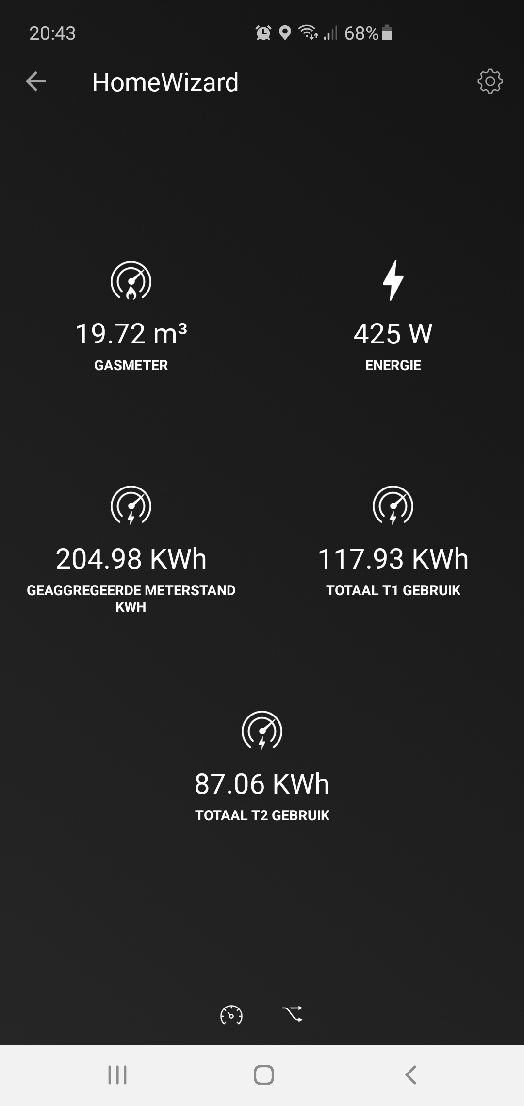

May I ask where the âgeaggregeerde meterstandâ comes from. Installation went fine.
Yes it is to give support for another application âPower by the hourâ that uses meter_power value.
I named it âaggregatedâ / âgeaggregeerdeâ because its a calculation of both used meters and deducted the productions from it. That âmeterâ number as result is an overall usage of your energy usage.
aggregated = (T1 usage +T2 Usage) - (T1 prod + T2 prod)
This meter number can be used as a source for âpower by the hourâ and give some insight on hourly, daily, monthly and yearly usage.

Did I understand you wrong that the values for delivering back to the grid would be hidden, if too low?
I still see them.
To be more clear, I personally would use âTotalâ in front of the gasmeter as well. To be clear that that it is not actual usage.
Same for Energy. I would use âcurrentâ (NL: huidig) in front of it as well.
But for you to decide.
Happy with the app!
They should but I recon if they are already added the stay there or I have to use remove code. What you can do is remove the Homewizard Energy device from Homey and add it again. That will confirm my thought. I cant test because I do have solarpanels and thus these have values.

You were completely right. After deleting the P1 dongle and adding again, these âproducedâ values are not shown anymoreâŚ
