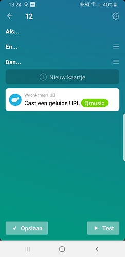

I tried it with an url in a logic variabele Qmusic (https://icecast-qmusicnl-cdp.triple-it.nl/Qmusic_nl_live_96.mp3) and it works.
So maybe the url you are providing is not okay, or need a little delay on the cast url so you definitely sure that the url is set in the variabele

Thank you guys for your input! I found the problem (strange one) when I realized (unfortunatelly not fast enough) that the only difference between our screenshots is the flow editor type.
I tried all the things listed below… but then thought maybe I should try one more thing: to create a flow on a mobile app… and it worked.
When I created a flow using a Web flow editor it behaves strangely, like described below.
