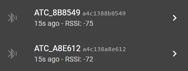

Immagine 2021-04-26 111031
What are these screenshots? They are not from Homey (at least I haven’t seen such screens), and they are not from Home Assistant (at least I haven’t seen such screens)…
https://tools.developer.homey.app/tools/ble

I’m using BLE Ruuvi app with success, ATC and other works the same they send a broadcast frame that just need to be decoded. So my guess would be to have a kind of generic BLE broadcast decoder, starting with ATC or public MI (like the picture) would be awesome. Unfortunately, I’m not skilled for. That’s a shame.
