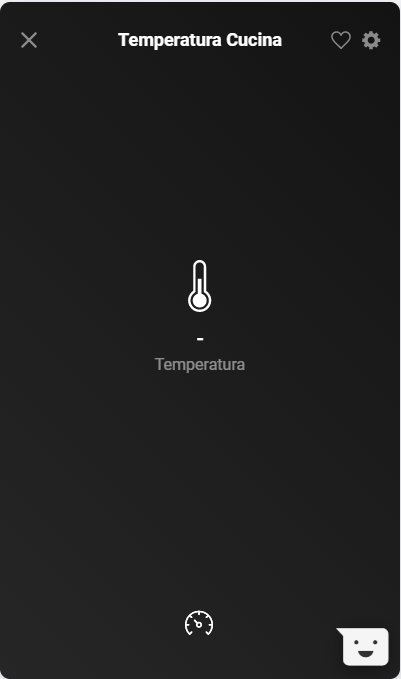

I have some cheap BLE Xiaomi Mijia Mi Temperature and Humidity Monitor 2 (LYWSD03MMC), with Telink custom firmware installed (Telink Flasher) and integrated in Home Assistant. They show in real time temperature and humidity, as well as the battery state.
When I add them to Homey through the Home Assistant app, I can easily detect all the “entities” (except battery state, don’t know why), but when added I cannot read the measurements.
