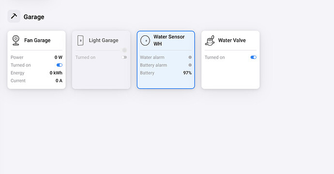

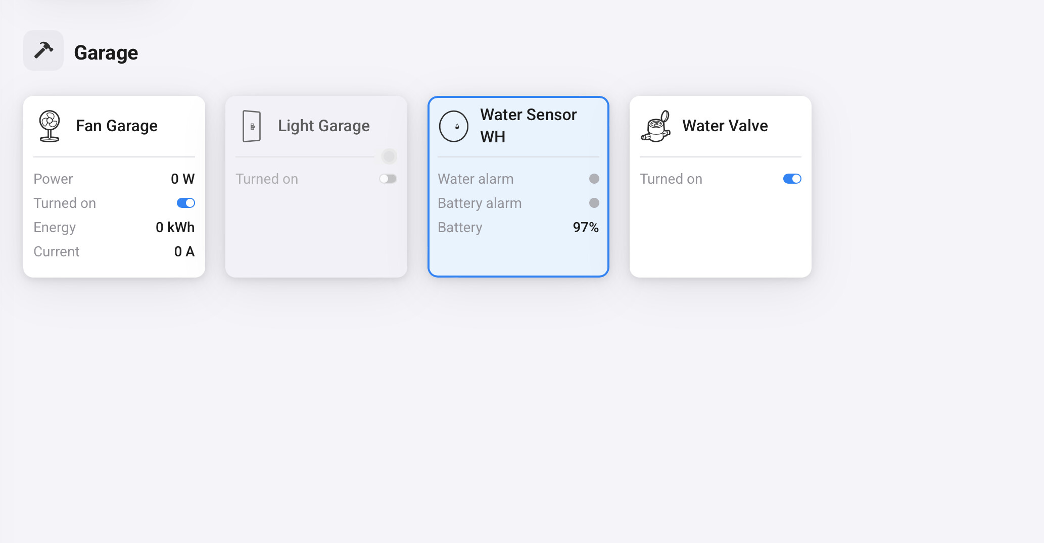

User Message:
    Water leak sensors dont react to water. Sensors without battery are still shown  as full and connected

The device log, this is the full time frame that is provided, shows regular updates of the weather sensor connected to your Homey, as well as the water leak sensor checking in every 50 minutes.
You mention in the comment that the water leak sensor did not trigger… at what time did you activate the water sensor? Did you do that in this time frame? Note that the time codes are based on Zulu time.
Can you trigger the water leak sensor once more and directly after that submit the app’s diagnostics code, mentioning your name and the time you triggered the water leakage sensor?

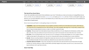

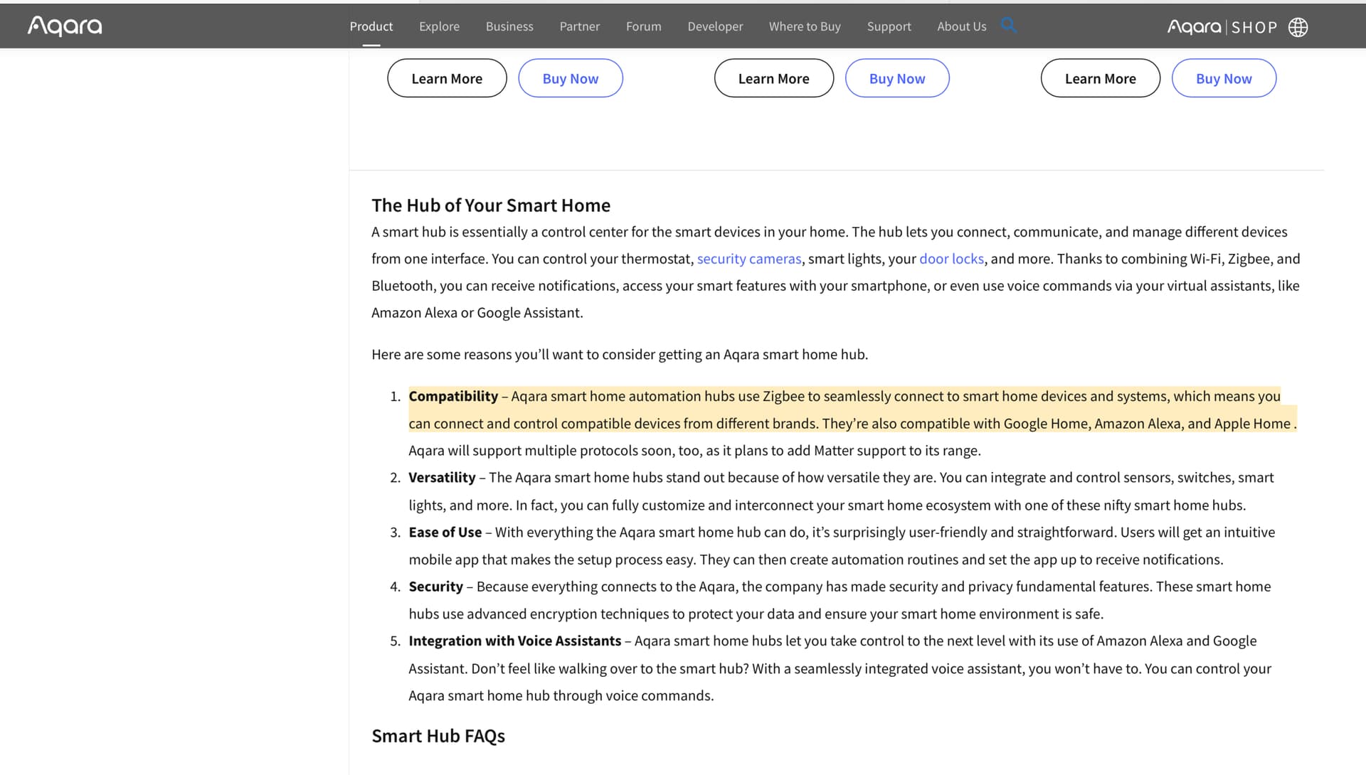

I read on another forum that Xiaomi/Aqara devices are not standard Zigbee protocol. Not sure exactly what that means or how that can be…thought entire premise on “protocols” was that they were standard LOL.

WOW so just ran the Zigbee last update script and my Aqara sensor on my water heater was last seen over 2 months ago…yet reporting 97% battery life?
I think sadly I am going to put the Aqara water sensors back on the native aqara IOS app and add them to Homekit and use home kitty to link my z-wave water shutoff valve.

I am finding out that even though Aqara states in their documentation and on their website that their hubs and devices use “standard” Zigbee 3.0 protocol, I am starting to believe this is not the case.
The M2/M3 Hubs…their website states you can add third party devices because hubs use Zigbee 3.0.
Trying to add zigbee smart plugs (INNR and Third Reality)as routers to help boost zigbee signal / network strength and I have yet to be able to add any third party devices.
Well after correspondence with them, it appears that is not true.
Additionally they then send this…saying if I purchase M3 Hub it you can add third party devices…
But once again documentation says “M3 HUB integrates third-party devices into the Agara Home app (currently limited to select device types, will be expanded over time).”
So has anyone been able to successfully add third party zigbee devices to M3 hub before I potentially spend money on purchasing it? Anyone know what those “limited select device types” are? Of course Aqara hasn’t responded to my question when I asked what those limited devices were LOL
