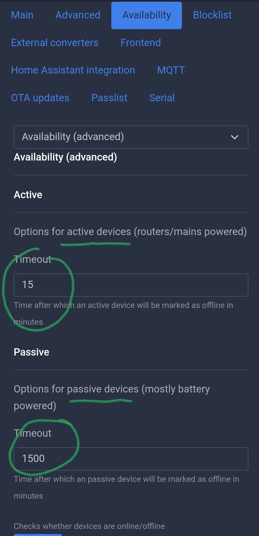

The Z2M zigbee controller has a built in availability check feature, because of the nature of zigbee. It’s odd Homey doesn’t have this check:
_
When a battery or when mains power is removed, it cannot send an update, so the controller doesn’t know.
Sensors cannot be ‘pinged’, while they’re in sleep mode when they don’t have updates to send.
Maybe Homey has an hidden “regard device as offline after x minutes” function, but I’ve never read about it.
