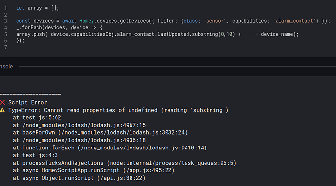

Here’s the code I used.
This is your code copy/pasted:
Replacing it with alarm_motion results in the same error msg
Here I replaced alarm_contact with measure_battery:
The code with alarm_contact again, but now without substring(0,10)
Is it a version thing?
Homeyscript v3.4.1
Homey v8.0.3-rc-7
There’s probably one sensor that doesn’t have the lastUpdated property.
This might work better:
array.push( device.capabilitiesObj.alarm_contact.lastUpdated?.substring(0, 10) + ' ' + device.name);
It will only call substring() if lastUpdated is defined.

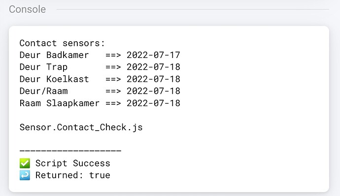

That did the trick, Robert! Thx!
@Joka There is a v motion sensor indeed, which returns “undefined”. So that problem’s solved.
But I can’t find an issue with the contact sensors.
Script with ?.substring(0,10):
Script without ?.substring(0,10):
I have to mention “Deur/Raam” is a < group > app device, with all contact sensors in it.
This returns nothing…

But (I can’t stand this) atm, it returns all of my 5 contact sensors without errors :face_with_raised_eyebrow:
