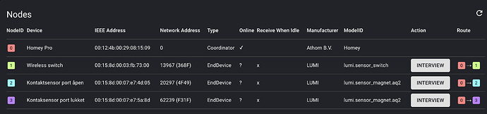

I have more or less the same experience. Seems for me, if the Aqara sensor is not communicating directly to my homey, it losses communication after a few hours.
I do not have the knowlegde to determine whether this is happens due to bug in Homey or in the sensor.
I fixed this by pairing the sensor serveral times, until it was communicating directly.

I’ve connected Ikea lights a while ago, and randomly and sometimes the Aqara temperature- and PIR sensors stop responding when they’re routed via such a light.
Odd: Ikea sockets work fine with the sensors…
Odd: Aqara contact sensors just don’t use the Ikea lights as hub
Non-responsive sensors are brought to life by
  • disabling the Ikea app
  • add the sensor without removing it prior to pairing
  • “Sensor is already added” message can be ignored
  • restart the Aqara app
  • enable the Ikea app

I have the same issue with one of my contact sensor. Both of them are speaking directly to Homey, but one of them stops working after a couple of days. The other is still going strong. I have re-added the one that is not working, and it then starts working again, but failed again after a couple of days.
