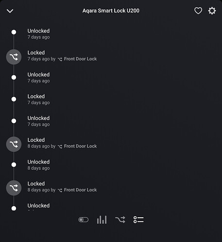

Now onto the problem. I have had an Aqara U200 lock without the Aqara hub since we built the house in July. The lock went into Apple Home beautifully and has worked there ever since. I bought a Homey Pro a couple weeks ago and have 99% of my devices working beautifully.
I connected to the lock with the Aqara app, put it into Matter mode, and the Homey Pro connected right up. It’s able to lock and unlock. I figured I’ll use Homey for automation and Apple Home for user and guest access. Everything worked great for a couple days. Now the lock isn’t working.

Does the lock still work from Apple Home?
Yes.
In that case, it sounds you’ve run into the (fairly common) issue of Homey losing connection to Matter devices. You’ll have to contact Athom about that: https://support.homey.app/hc/en-us/articles/360015784034-Submitting-a-support-request
