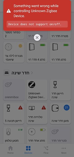

And when i add them to homey (2019)
Thay added but not working
When i test them, i get error this decice does not support on/off toggle.
Also after the setup of the switch, the homey give me a messege that says

Remote switches, meant to only trigger flows, are not supported by the generic zigbee driver.
As it’s an Aqara switch, is the Aqara app installed?

It’s added as a generic Zigbee device, and Homey only has very limited generic Zigbee support, so it’s probably related to that. You have to wait for an app to support the device.

Apparently not. If Homey says it’s added as a generic Zigbee device, it couldn’t find a driver for it.
However, given your general issues with adding devices, it may have been added “half”, I don’t know.
All I can suggest is to look at the first post of the Aqara app thread, there’s where all supported devices are posted (however, they need to be exactly the same, so the same model/manufacturer ID, not just look the same).
