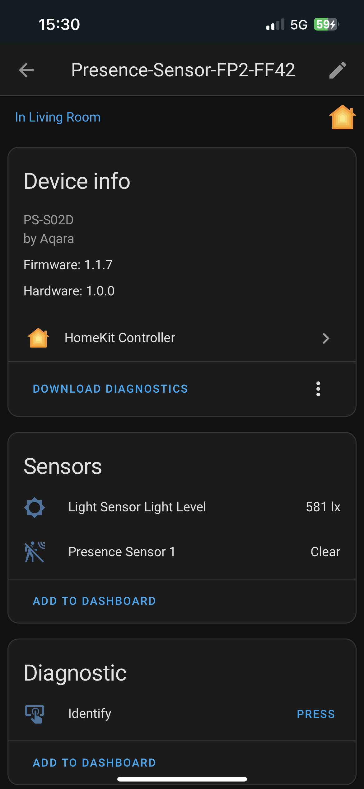

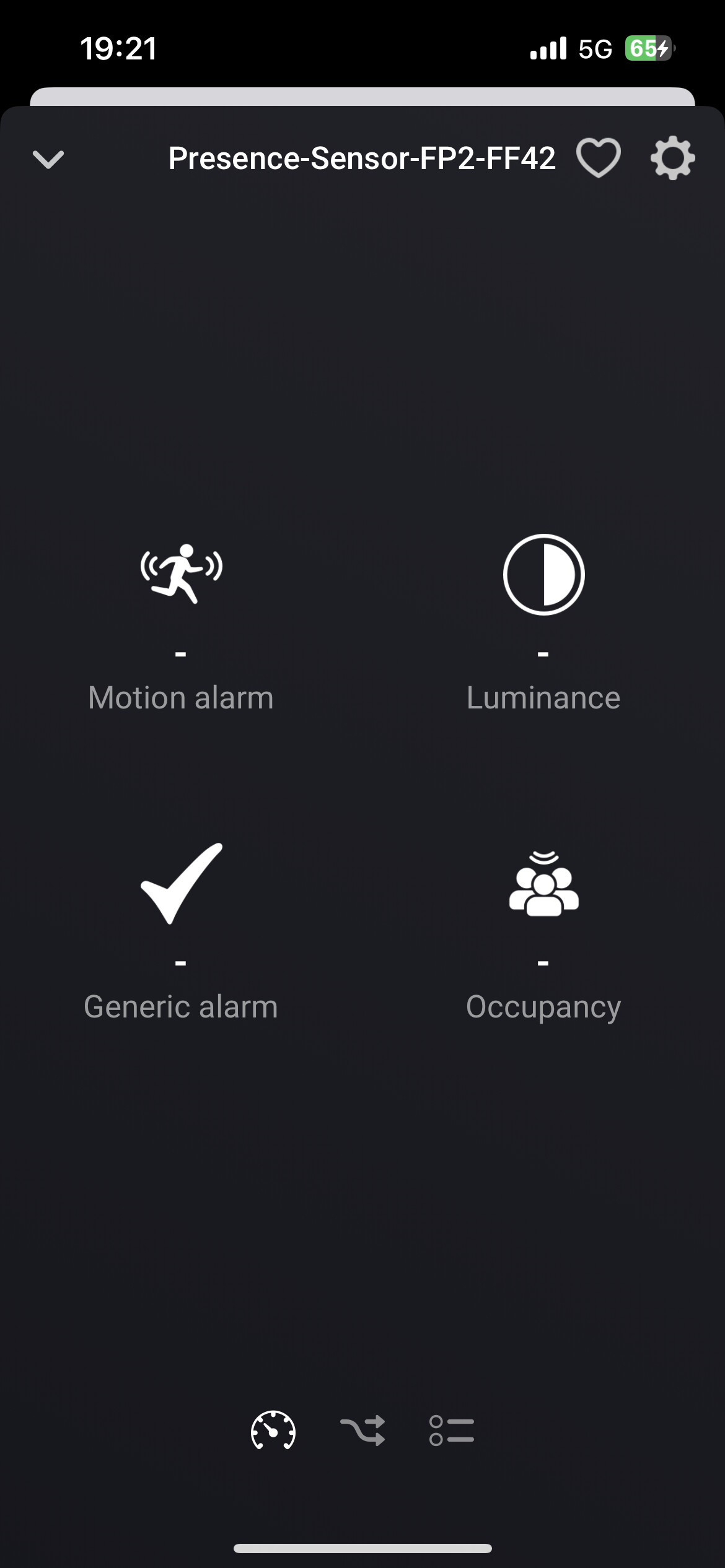

I selected the sensor in devices & services on HA, you see the device info etc and under the section sensors i selected presence sensor and hit settings icon in right top, that showed me the menus to change device class. After you’re done hit update and re-add it to homey and it works
Ah nice! So we both learned a thing or 2 today. Thanks!

Okay the zones are showing up in HA, but homey doesn’t detect multiple motion zones. I tried to give them different device class names and i could get up to 3 zones into homey but i need to test more to see if it can do what i want
