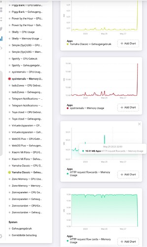

Athom states an app should not use more than 30MB.
Did you send a message to Martijn about this?
He’s always very helpful:
The Athom Hue app did also behave quite odd for several users, memory going over 60MB every x hours, so they restarted the app every x hours as workaround.
When you look at Insights, that seems to be true, but on the other hand the Memory Statistics (…more>settongs>general) do not show memory for disabled apps.
I was trying to build an app once, removed all of it, but Insights still shows 6MB after 2 years :woozy_face:
Or the Http Request app, it has two entries!:thinking:
In my opinion the Memory Statistics shows the real current RAM use.
Insights is just not removing the leftovers / updating inactive apps.
