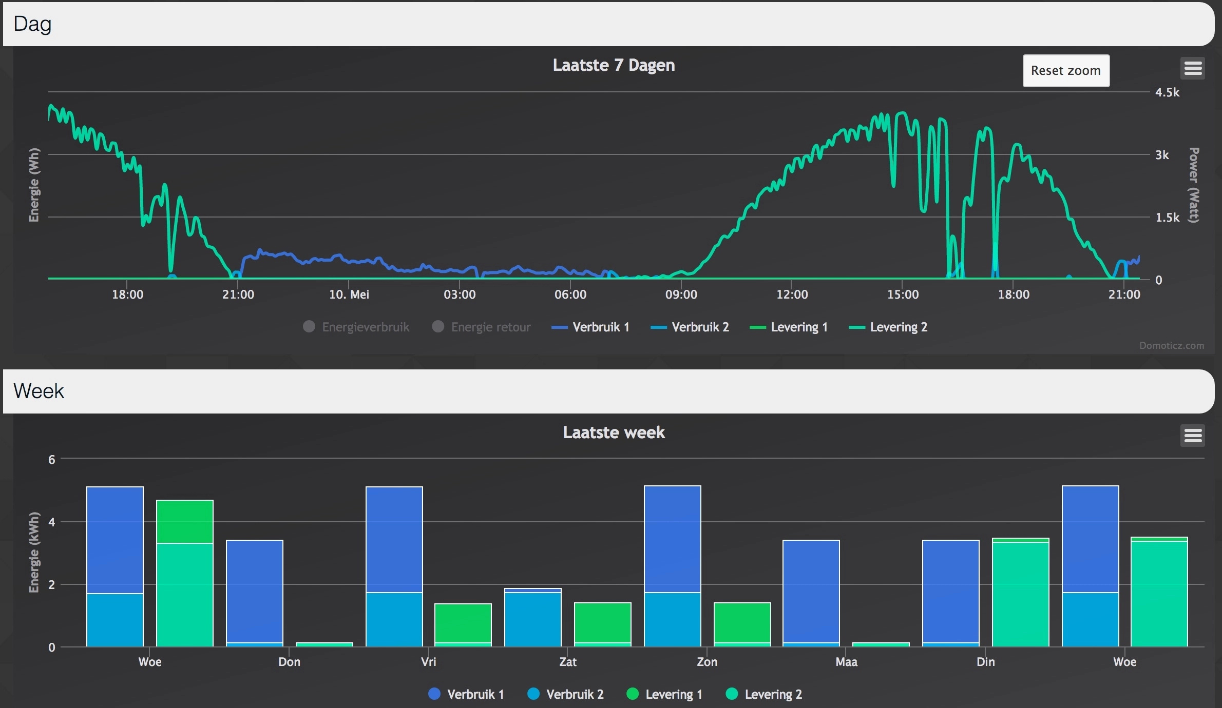

Ahh ok i was using domoticz and there you could see the current power return next to the current power usage. then you could see the total of the power return. now i can only see the difference between both.
The total production meters are seperate for production peak, production off-peak, consumption peak, consumtion off-peak. So you can construct the second bar graph you had on domoticz from the collected data.

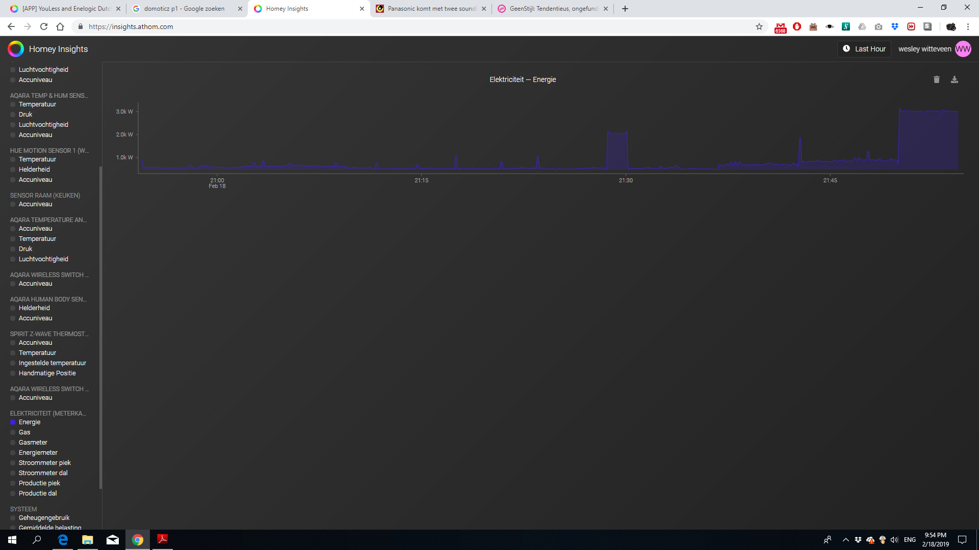

Where do you get this graph? i only have homey insighst
Yes, this is from insights Homey V1. But you can get the same from V2. Just select a timespan of more then 1 hour. And you can download the data and make your own graphs in Excel.
