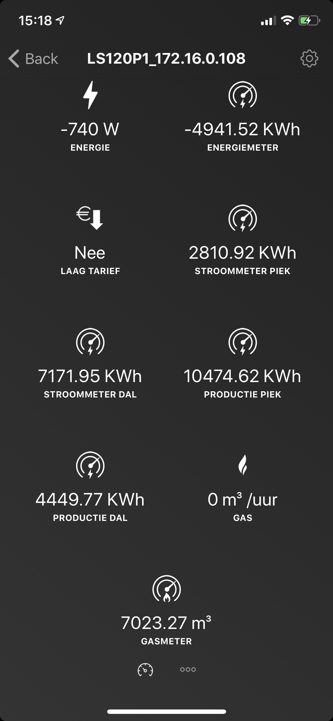

The app works well on my iPhone,
The measured values ​​are also correct.
see Appendix.

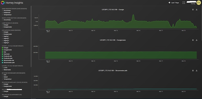

But in Homey Insight I have many flat lines. if I move the mouse over the line then the right values ​​will appear in the right-hand corner. also for longer days of measurements. see Appendix

Do you also have those flat lines in Homey Insight?
The ‘flat lines’ seem correct. Those are the power meters that do not change much over time. Look at the y-scale (KWh). They seem correct :slight_smile:

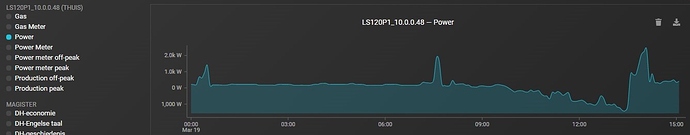

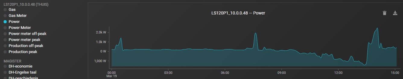

@Top_Homey I’m not sure If I understand you correctly. The production over time is represented by the power graph. See below example of the power of a single day. If your house is drawing power from the grid, it is represented as a positive number. If your house is delivering power to the grid, it is represented by a negative number. So in below example graph you see that power was produced to the grid between 9am and 2pm.
How is that different from what you are looking for?
And with HomeyV2 Insights, but from a different day, it is exactly the same (just the way that Athom displays it, the 0 line is not so easy to recognize)

if you look at my pictures a few posts above. then you see that there is in (productie piek en dal) is an almost flat line.
the same goes for (stroommeter piek en dal).
Maybe I can explain it better, if you look at the gas consumption you see what you have consumed per hour.
And with gas meter you see the total consumption absolute. If you then take a time span of a year then you see the total consumption rise.
This is what i mean, that if the line goes below 0 watts. then the production peak should go up.
For the same value as what it goes down.
Ah, well. There are only two ‘real time’ meters: Energie and Gas. The others are cumulative meters, so they do not show actual usage. They just represent the meter value as you can see on your physical smart meter. If you want to do more advanced Insights based on the data, please use an external graphics engine, or ask Athom to create more fancy graphics :slight_smile:
