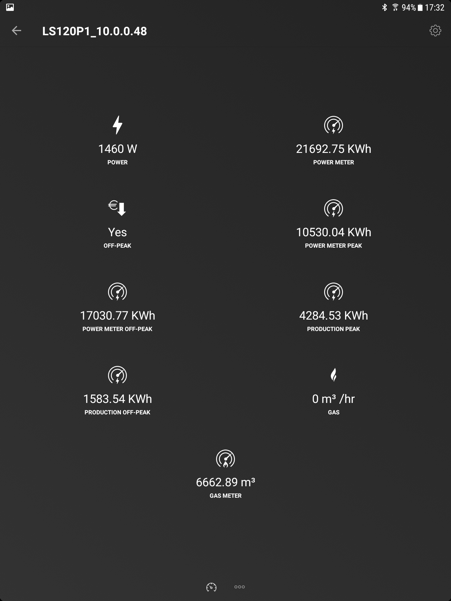

I got a LS110 with Gas meter software. I installed the new Enlogic app but I can not find the right way for the LS110 measuring gas is this possible with the new app. in the old app i used the water measurement which was Ok
The Homey app is not written to support ls110 with special gas firmware. But if IT worked before for you with water meter, it should still work. I didnt change anything in the device drivers. But does the ls110/120 E driver not work? It would only show the gas usage as power. Did you try that?
The Power works that is no problem But I would like to have
L/min and M3 I also could not fined this in the new app

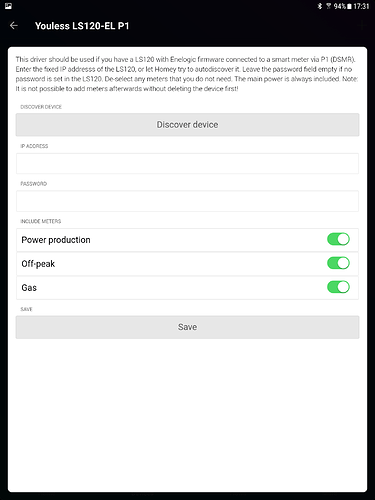

New version 2.5.0 was just uploaded to the appstore, awaiting approval by Athom. It is in the beta stream because there are some significant changes in the pairing of new devices.
  • The pairing windows are now optimized for Homey V2 Mobile.
  • For the LS120 P1 you can now select which meters you want to exclude during pairing. (e.g. exclude gas if you have no gas, or exclude power production if you have no solar panels).
