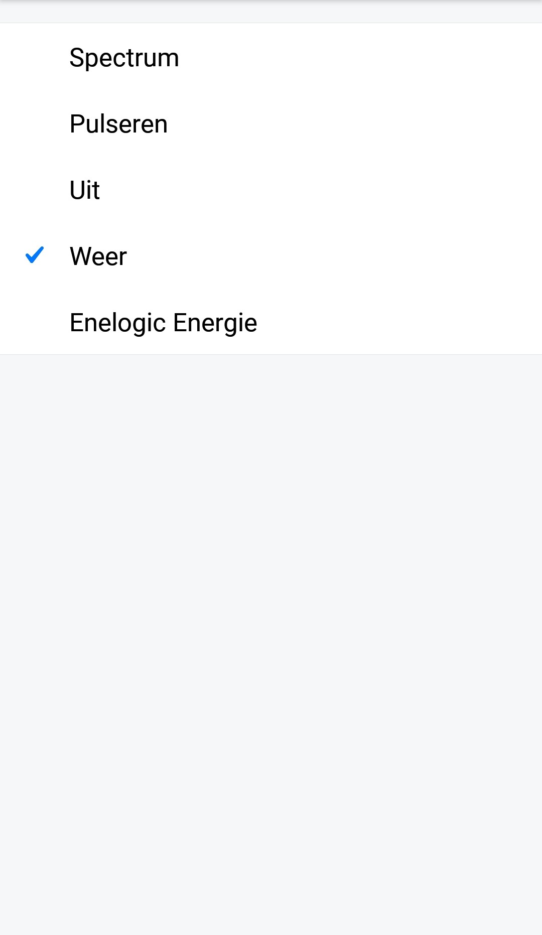

With the v2.3.0 update, the led-ring is changed to green/red and overrules my screensaver. How can i turn this off?
Ok thx. So my attempt to make the ledring work for Homey V2 failed then :unamused:.
Can you not select a different screensaver anymore?
The Enelogic Energie screensaver is not selected but is the active screensaver. When i switch from off to weather the correct screensaver is active again.
After updating to 2.0.2 and a reboot the screensaver got activated but luckily I was able to disable it. And it stays off. Nice feature but not for me :wink:
