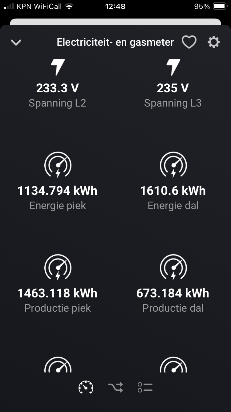

Hello. I’m having a problem with my Youless LS120 P1 meter in Homey. I have 2 of them, each connected to its own HP2023. In 1 environment however the Youless keeps losing its 3-phase capabilities (Power, Current, Voltage). When I change a setting (for example polling interval by 1 second), then the device becomes unavailable saying “Migrating, please wait” and then after a minute or so it comes back with all of its capabilities. When I then check a few hours later, they are all gone again. Pretty frustrating…
Does anyone have an idea of what causes this? And hopefully how to solve this?
Thx!
@Gruijter Do you have any idea what causes this?
I can only think of the second youless getting corrupt data once in a while. This makes Homey think it doesnt have certain capabilities. The do both have the same firmware and settings? Did you try swapping them around to see what happens?
Edit: and try relaxing the polling to 5 sec or more.
