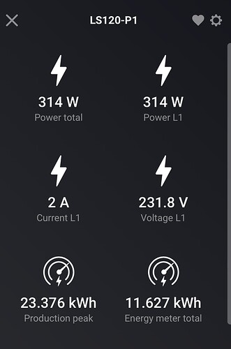

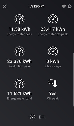

Just started on a Youless LS120 on the P1 port of a KAIFA with DSMR 5.5 (on a 1-phase system) and am wondering if I can do polling every 1 second, currently the minimum in the settings is every 10 seconds. Is that technically possible?
Also, I am on a dynamic energy contract, so there are no off-peak usage/times, it is all one value, but when I disable ‘report OFFpeak’ in the settings I don’t have the full total usage. Would it be possible to have a dynamic mode in settings where peak usage+off-peak usage are added together and shown as one value? The same would apply to the production peak+production off peak, it would be great if it was in one value.
