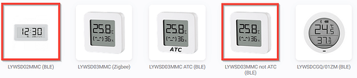

Version 1.2.16 — Support added for LYWSD02MMC and LYWSD03MMC with standard firmware.
Unfortunately latest LYWSD03MMC have patched firmware by default, which makes flashing ATC firmware much harder. More on this issue - Xiaomi has released new 2.1.1 firmware · Issue #298 · atc1441/ATC_MiThermometer · GitHub
