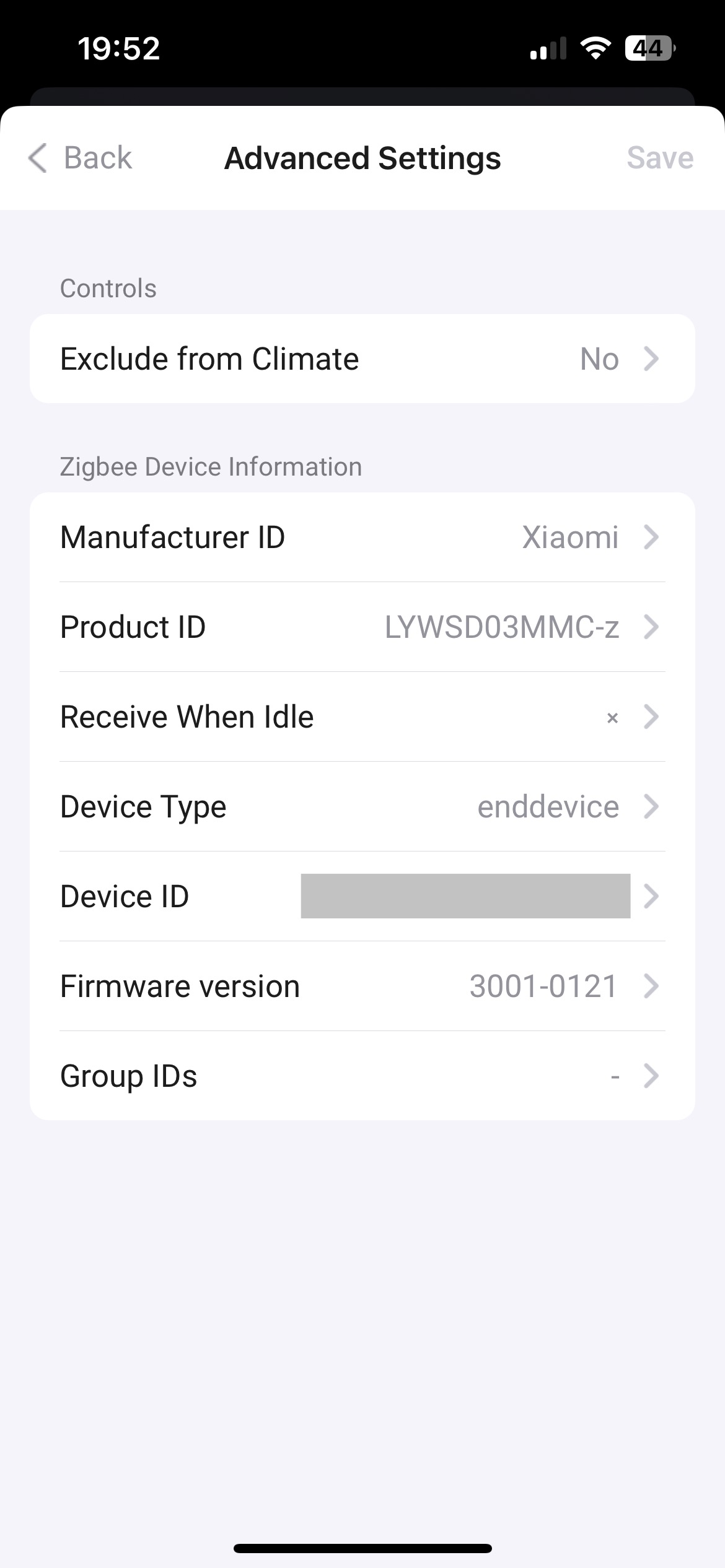

I am getting the same error, can you help me with how you solved the problem.
Thank you very much.
New test version published, PLEASE test Bluetooth devices, if it’s still working - eventually send me diag. report. During handover, I found out that BLE is polled despite of not having device, so I changed it so it will poll device only in case any is registered.
