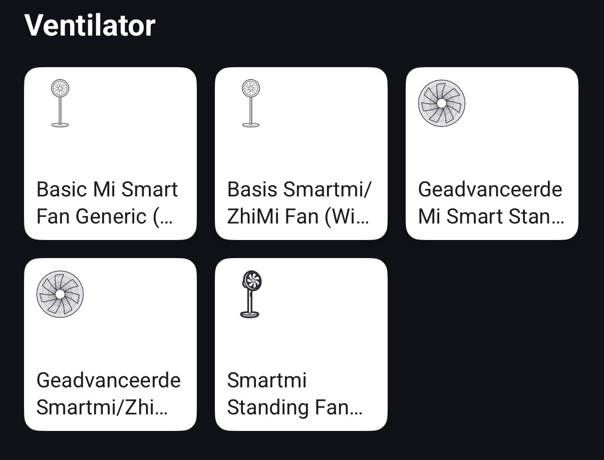

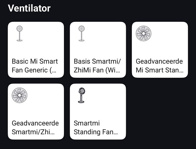

So i bought myself a Xiaomi Smart Standing Fan 2 Pro. Works great. Now trying to connect to Homey Pro.
Which icon do i need to choose?
Also, where do i find the info to connect.
Like, what do i fill in here:
Many thanks for all help!
—> Use Advanced Mi Smart Standing Fan MIoT driver
