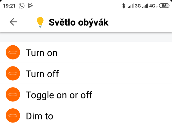

Yes, but this shows the device has the correct capabilities. So the color action cards should be available as well. Could you post a screenshot of the action cards available for you.
Alright so miracly now the color palette turns on and changes the ambiente led strip on 650. However there is no option to turn on/off the led strip in the Homey app. Also no action refers to it in flows. Is that how it should be?
Hmmm, could be I have not created that card yet. You can submit a feature request on GitHub if you want this. Not sure when I get to it to add this.
