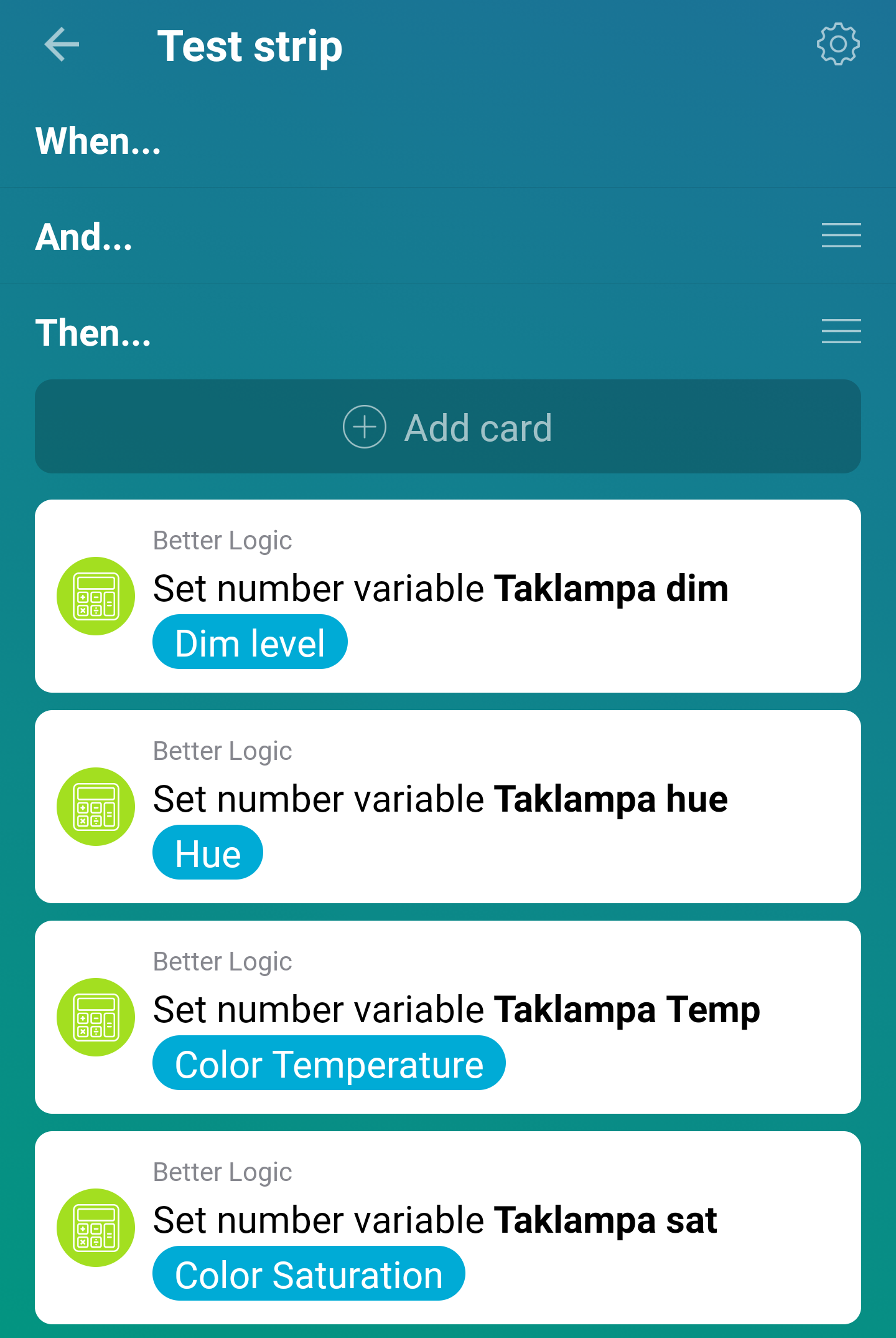

I’m looking to control my Yeelights by using Logic/Better Logic for saving/altering current state (on/off/color etc) - thus far I’ve been able to make it work using Number variables, like:
…But not String, like below:

The above “command” doesn’t work, so:
  1. What are the available commands to send?
  2. Does the app register lights (that are turned off) as Dim 0%?
What I’m trying to accomplish is:
When window open (sensative guard strip) - save current state (dim/hue/temp/sat). Then turn light red (or whatever). On window close, then reset state to previously recorded variables.
Cheers : )
You should have a look at the API description to see how you should send a custom command. In theory it should be possible to achieve this but you might need more custom command cards following each other.
