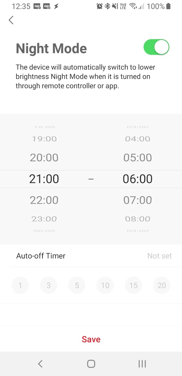

I think I see the issue, it does not update the night mode when the Yeelight app schedule changes it (Until a device turns on the light).
I use the Yeelight schedule (within mobile app) so the lights come on in night mode between 21:00 and 06:00
My flow checks if night mode is on before turning on the light from a movement sensor, in case the light has been switched to day mode intentionally. So when turning on night mode via the scheduler it does not register with Homey.
If that is the case it might be an issue with the Yeelight api where it does not broadcast an update when changed through the schedule. There is then no way for my app to know it has been changed. You should ask the Yeelight company about this
