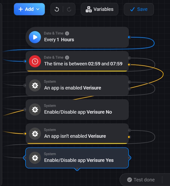

I deactivate the app from 22:15 until the next morning 06:30. And at the other moments, I de-activate en active the app every 30 seconds. Since I made those changes, no more mails from Verisure.

I have all kinds of devices, doors, temperature etc. First I tried disabling the flow in which I looked at the status, but that didn’t work. Still an email. After that I decided to stop and start the app. That works fine with me.
Working with emails from Verisure is possible, either direct to Homey or via IFTTT, but for now I leave it like this until they fix this problem. And if not, I can make changes after that.
I made a screenshot of the flow in which I (dis)able the app. If you have more questions, please let me know.

Thanks for the screenshot appreciate it! I hopefully get the homey either tomorrow or on monday so will give this a go then!
