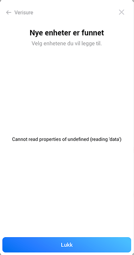

Though, I get one issue when trying to install the keypad device. I get the message: “Cannot read properties of undefined (reading ‘data’)”
I assume this is because I got this brand new keypad.
Is this a known problem?
Allright, I sent a message on slack to them as it seems like whatever this is has not been resolved yet.
Though, some more information about the issue would be nice…
