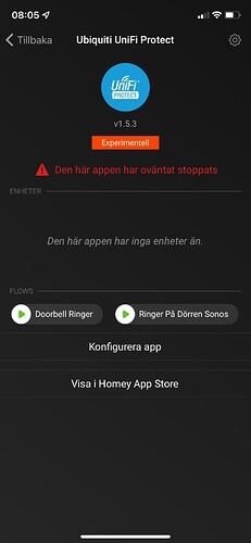

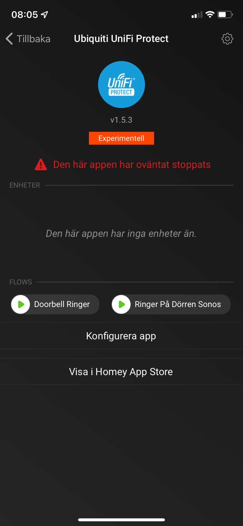

If I run 1.5.3 I get the “the app unexpectedly stopped”

I have the same problem with 1.5.3, with the same message “the app unexpectedly stopped”
