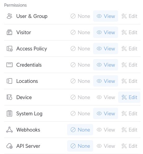

I managed to switch from the network API key to an access API key for this app. I did not find any possibility to add 2 API keys (protect & access).
Now I am able to add all devices like the cameras & the reader. But, by pressing on the camera, homey tries to show zhe stream, which does not work. There is no error message.
Later I want to configure a „if a user shows its nfc-card to the reader & identifies itself“ then „open the door with the nuki app“ (another homey-app). Hope, it will work with these permissions:

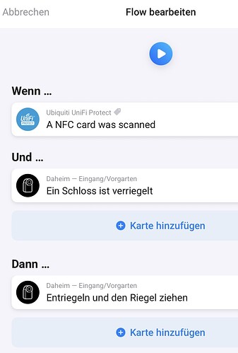

Tried to create a flow:
If someone with a valid nfc card (or toucpass) is recognized by the reader pro, the nuki door lock should open the door. But, this is not working. Also, opening the door „when a door access is detected“ is not working, too.
The Nuki app itself is working fine. Both, reader pro and the door hub are succesfully added devices.
Would be nice to get some help with this.
Did you add a NFC card in Protect? First test with a Timeline message. It’s working for many installations.
Yes, I added a nfc card… it is working with the reader itself. But it is not working with the homey-unifi-app.
What exactly do you mean with „first test with timeline message“?
It is such a pity… this is exactly the app I was looking for, but it is not working.
Can you send me a DM with screenshots from UniFi and Homey Flow and Settings?

Sure? At the moment I do not want to use the cameras. First, I just want to tell the nuki lock to open the door after the reader pro saw a valid nfc card (touchpass) or.
Please send me first the screenshots in a DM and we talk there about your problems.
