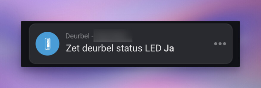

I have the Doorbell pro but cannot set the led on or off.
Changing the following card to “Ja” or “Nee” and test it, doenst change the led even tho it doesn’t report an error.
What are the rights of the user what your using for the integration? View Only ?
Restart Protect and your Doorbell, I don’t have this?
What for ALARM do you have created?
Didn’t think about that, that was it … Thanks
It looks when protect has an update a restart of the app is useful… i have no issues at the moment :raised_hands::ok_hand:

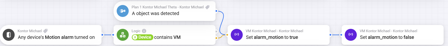

Concerning Smart Detections and “when triggering” intensity
Protect 5.2.42 was released tonight(today) and it made an issue (re)appear:
  • “[flowxxx] has been disabled because the Flow executed too many times.”
Spec:
  • HP 2023
  • Advanced Flow using when “[Specific Camera] An Object was detected” card.
  • One or more of those when in same flow
  • NVR PRO
  • A mix of cameras in the system
Timeline:
  • All flows using the when were disabled this morning when cameras detected.
  • Proceeded to test only one specific flow with only one camera. Immediately flow disables.
History:
  • I had this issue before when using the [any camera] Object was detected when card. Can understand lot’s of triggering then when many cameras are present with high traffic.
  • Switched over to [specific camera] Object was detected when card and spread into multiple flow and the flows stopped being disabled.
Timeline example
Just this simple thing disables immy from one detection.
This is what i have been using successfully for a longer period.
Some cameras but not very big system.
