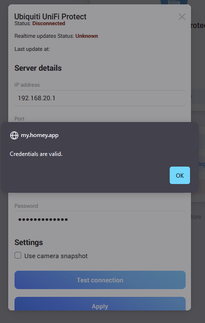

I got it to a point where it seems it somewhat have access, it says the credentials are valid, but the status is still “disconnected”:
I temporarily disabled all blocking rules for VLANs to troubleshoot.
Ah, it got sorted with a restart of the Unifi Protect app.
