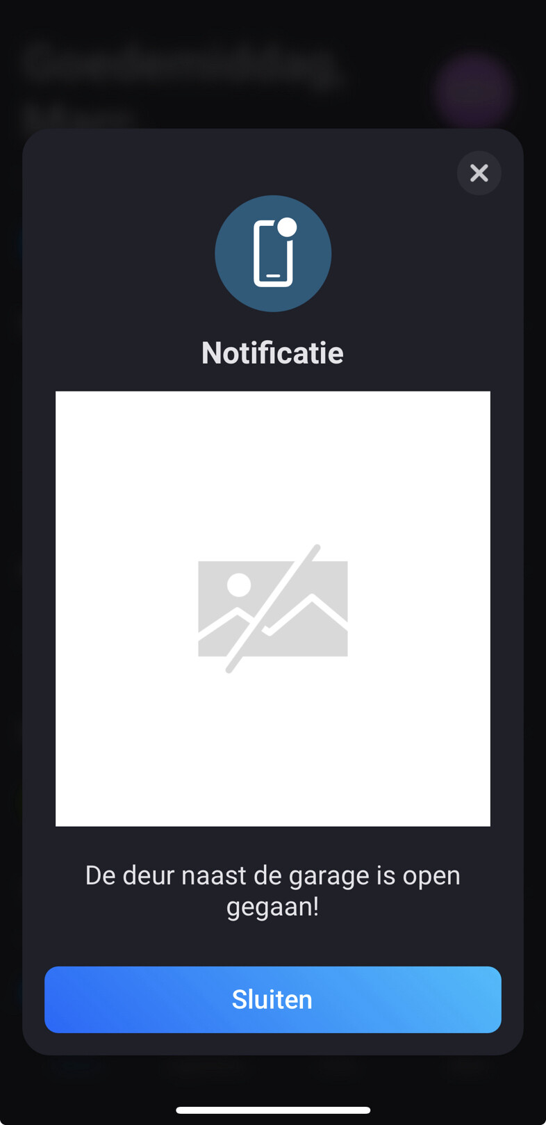

I’ve done some testing with this app in the past and was able to get the following test flow to show a snapshot image on a push message on my phone.
I recently moved the home to an isolated IoT VLAN network. The camera’s are still in the main network. The image that is shown on my phone is shown below:
This is the test flow:
Any suggestions to why the image is not shown? Related to the different VLANs?
If so, any idea on what kind of firewall rule(s) is/are needed to get the image through?

You can probably fix this by deselecting the option “Use camera snapshot” in the settings of the app, this is only for when you have enabled direct access on the camera it self.
Thanks @PhAnt0m , this brings me one step closer to the desired end result. When testing the flow I can now see the image in the flow when hoovering over the cameras name.
The unfortunate thing is that in the push message itself it still shows the image as shown in my original post.
Do you have an idea why that might happen?
Thanks, Marc
This did the trick, big thanks @PhAnt0m!
