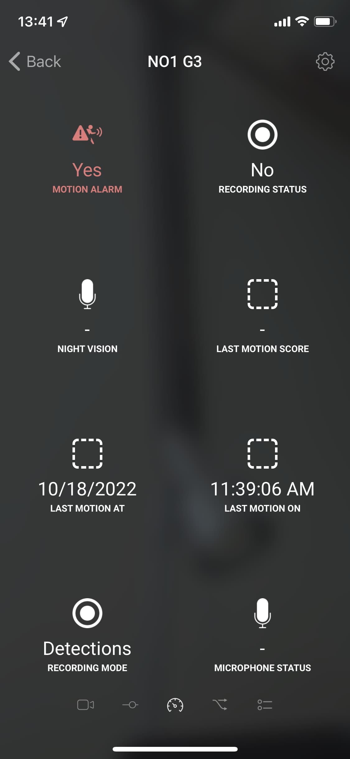

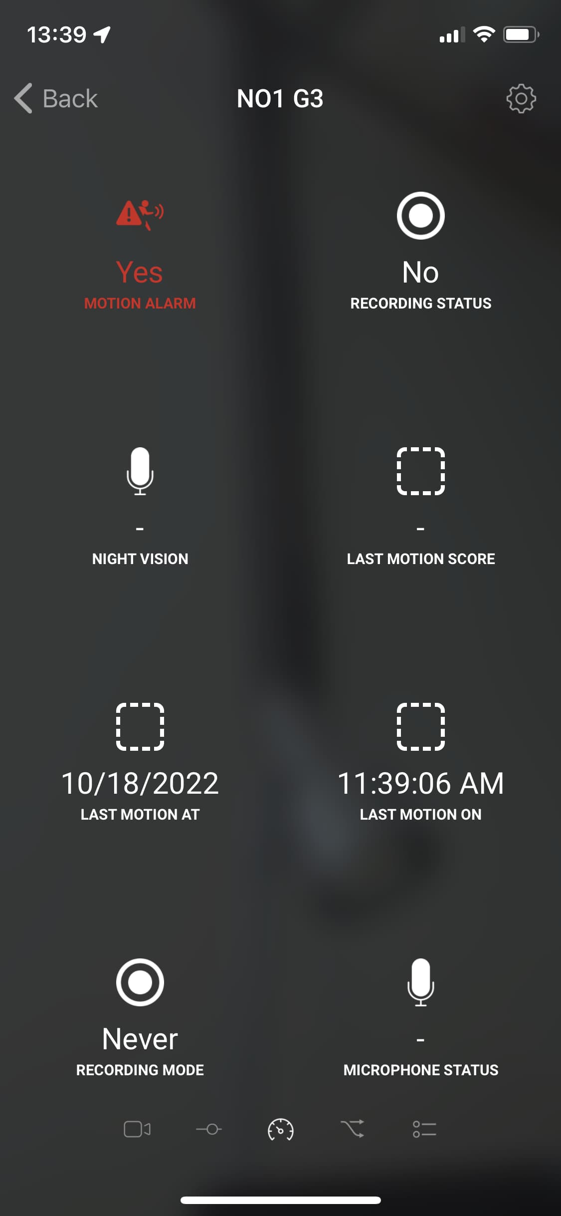

Can you show me in the gui what options is changed ? Or what the problem is?
If a camera has “Recording mode” set to “Detections” and this is changed to “Never”, the camera will change “Motion alarm”, as expected, to “Yes” on the next detection BUT will not change back to “No” again. (It hangs on “Yes”)
Then changing “Recording mode” to “Detections” again. - “Motion alarm” is still showing “Yes”.
Then after the first detection the status “Motion alarm” is set back to “No” again. And is working as it should for following detections. (Switching to “Yes” on detection and back to “No” when detection stops)
Then if I change “Recording mode” to “Never” - it starts all over again…
(Conditions: I switch “Recording mode” to “Detections” or “Never” manually in the Protect webapp. Or auto via a flow)
