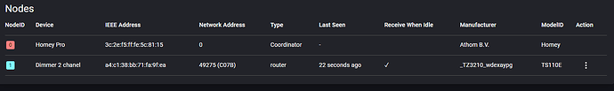

Hello all,
I am trying to add an OXT double dimmer to Homey. It is possible with holding for 10sec button that is on device. I am using Tuya Zigbee application. It should be added as two different devices but in adds only one. Means that I can only control one electrical circuit. Any idea how to do this to have two separete devices for the same dimmer module.
Link to the device details:
Sometimes it works to perform an interview on the device from this page.
This is how it looks for my Homey. No other Zigbee devices.
“Action (3 vertical dots to the right) > Interview”

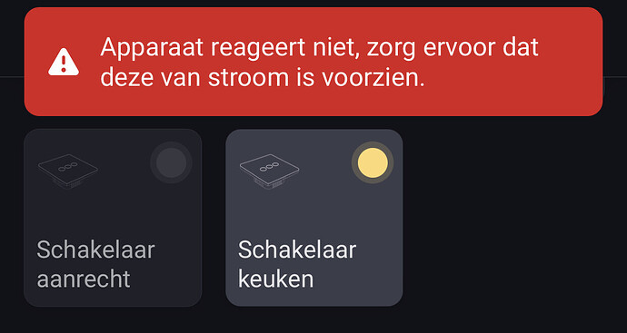

Hi community,
Recently Johan Bendz added my Zigbee Wall Dimmers to his Tuya Zigbee app (respect for what this guy means for the community o ).
It seems to work fine, however often, when i want to switch it on/off i get:
Which means as much as: device is not responding, make sure it has power.
Where a couple of minutes earlier or later i have no issue.
So functionality works however often it reacts unreliable.
  • Everthing is up to date.
  • Wall dimmers are always powered (230V).
  • Wall dimmers do have blue wire (connected).
  • Zigbee network reset, done.
  • Working on the test version of the Tuya Zigbee app
Issue persists: (device is not responding, make sure it has power)
‘apparaat reageert niet, zorg er voor dat deze van stroom is voorzien’
The error message is not specific enough as those devices are always powered :man_shrugging:.
Homey Developer tools states:
Is there anything more i can try to make these Zigbee devices work flawless?
I see this message also with some E27 RGB bulbs (these are also always powered).
